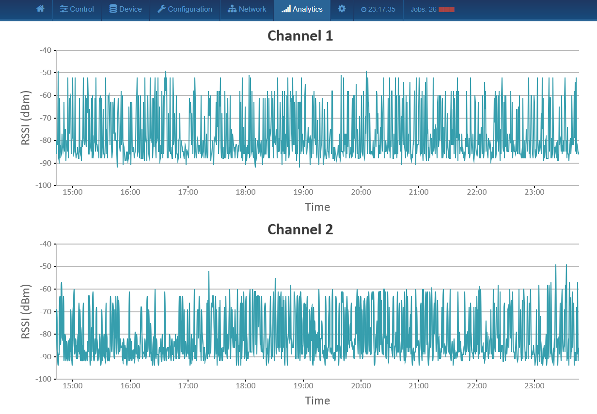

I have the same problems with lagging and extremely slow response to commands regardless if they originate from the web UI or from a wall switch sending commands ove the network (like e.g Aeotec Wallmote Quad). It takes from 7 to 40 seconds for a lamp to respond to a command.
I don't think I have excessive noise levels as I live far from any disturbing sources - unless the Raspberry Pi/Razberry themselves are causing disturbance.
My background noise and zniffer history is attached. Furthermore, when starting the UI, the status of the different lamps seem random; sometimes the status of the different lamps is updated correctly, sometimes it seems total random.
Btw. how do I disable polling (as mentioned above) and what consequences will that have?
Best /Brus-Per

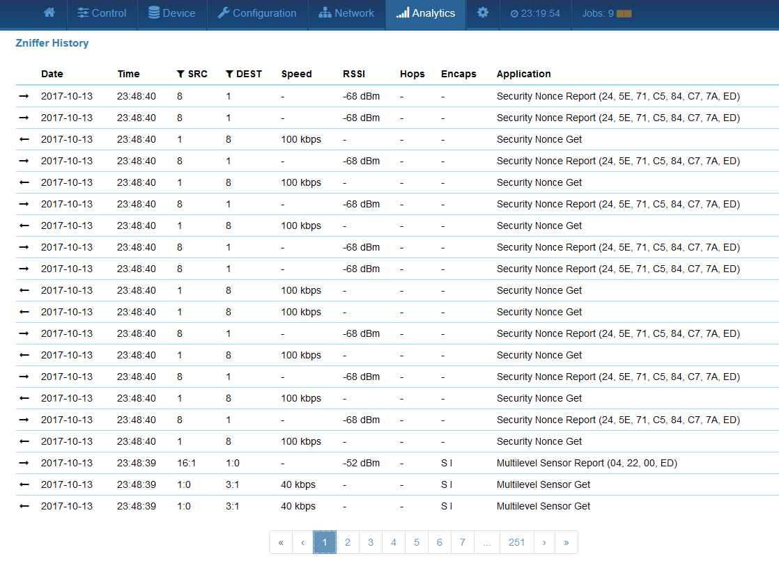

Hi Brusan,
Node 8 seems to be not reachable. I've had the tham with an aeon plug. a reset of the plug and re-include did stop the flooting with nonce reports. and my network was as quick as on the first day ;-)
search in the smarthome ui in the active apps - tab for active polling apps, you could easyly stop or delete.

Hi janjan.
I have already removed all apps that was not mandatory (i.e they are not actice) but I made a new sweep through the list and I can not find any polling apps - at least judging from the descriptions of the remaining apps.
I see from the screen dump provided by Isacsson above that his job queue is at 26. I only rarely see a job queue of less than 130, usually it is of the order 150-180 - maybe that can explain the slow response?
br /Brusan

Hi bruson,
Yes more than 100 Jobs in the queue slow the system, if they all running. I have had 30 running jobs, "nonce reports" of a failed device.
@poltos, you are the specialist, how many running jobs are possible without slowing down the system?
best regards
janjan
Re: Very slow communication
a job usually takes about 10-20 ms. and 10 ms between sending jobs. This gives about 20-30 packets per second. But since Get requires an answer, it takes even more to get and answer. This slows down to 10-15 packets per second in a normal environment and less if there is hard routing or dead nodes.
