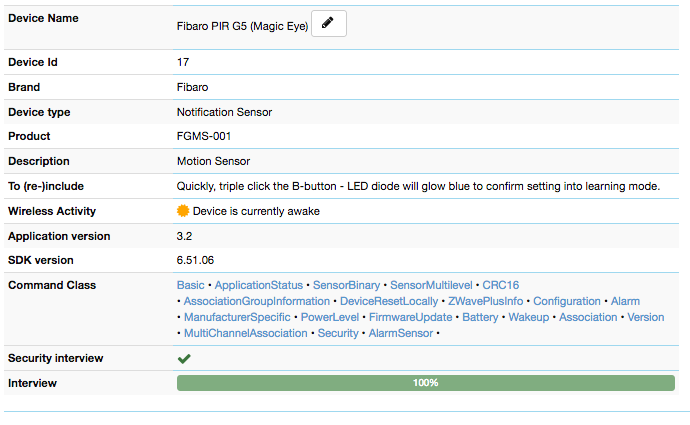

I've installed a FGMS-001 Application version 3.2 / SDK version 6.51.06 on my Razberry v2.3.5.
Schermafbeelding 2017-08-19 om 13.44.57.png (68.58 KiB) Viewed 19200 times

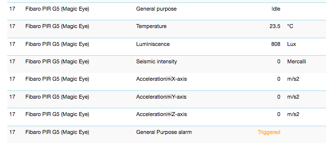

I can see all sensors in "Expert mode"
Schermafbeelding 2017-08-19 om 13.46.30.png (44.79 KiB) Viewed 19200 times

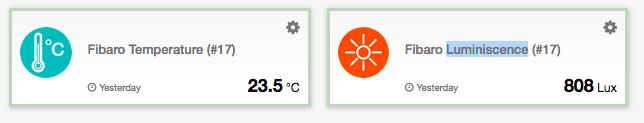

But only temperature and luminiscence show in my smarthome:

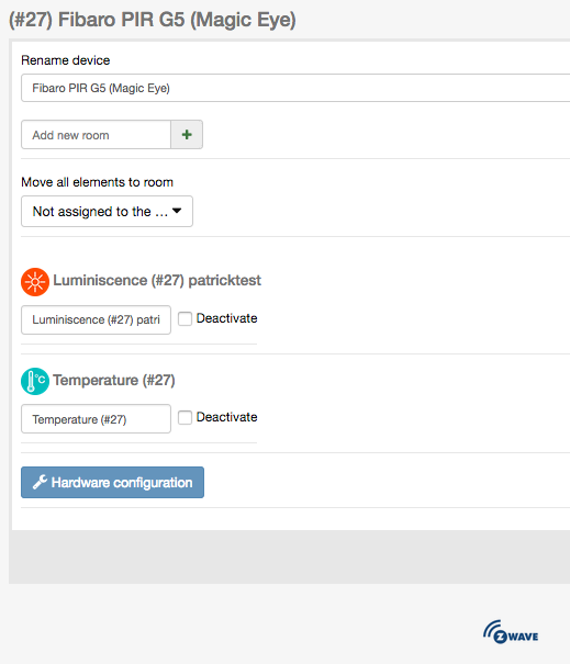

Re: Missing items on Fibaro PIR G5 (Magic Eye)
Go to Devices -> Manage and check if there are "subdevices" under this #17. If not, we need to check why smart home engine do not get devices from the expert engine

Only Temperature and Luminiscence show up as "sub-devices":

I have the same issue with some fibaro door/window sensors. I only get "tamper" sub-devices but no actuall contact/sensors/switches to see.
Interestingly this doesn't seem to be a problem on a naked, fresh re-installation of razberry with newest jessie version. But on my existing system with your 70 devices it simply doesn't work anymore sind 2.3.5. I also alread ex- and re-included several devices without luck....

This is a bug in Z-Way 2.3.5 :( . The Development is inform and will be fix it. A many device with Alarm Class are affected in this Version
