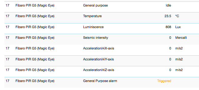

I've installed a FGMS-001 Application version 3.2 / SDK version 6.51.06 on my Razberry v2.3.5.
Schermafbeelding 2017-08-19 om 13.44.57.png (68.58 KiB) Viewed 19212 times

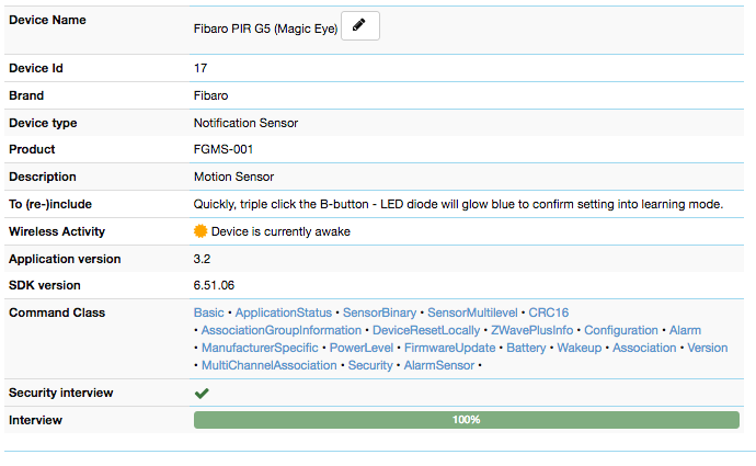

I can see all sensors in "Expert mode"
Schermafbeelding 2017-08-19 om 13.46.30.png (44.79 KiB) Viewed 19212 times

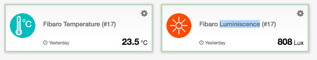

But only temperature and luminiscence show in my smarthome:
Schermafbeelding 2017-08-19 om 13.47.57.png (26.72 KiB) Viewed 19212 times
What am I doing wrong?

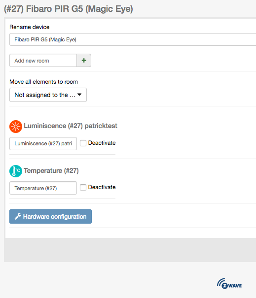

Posted: 21 Aug 2017 23:23
Go to Devices -> Manage and check if there are "subdevices" under this #17. If not, we need to check why smart home engine do not get devices from the expert engine

Only Temperature and Luminiscence show up as "sub-devices":
Schermafbeelding 2017-08-22 om 11.12.09.png (51.62 KiB) Viewed 19197 times
Any idea's?
