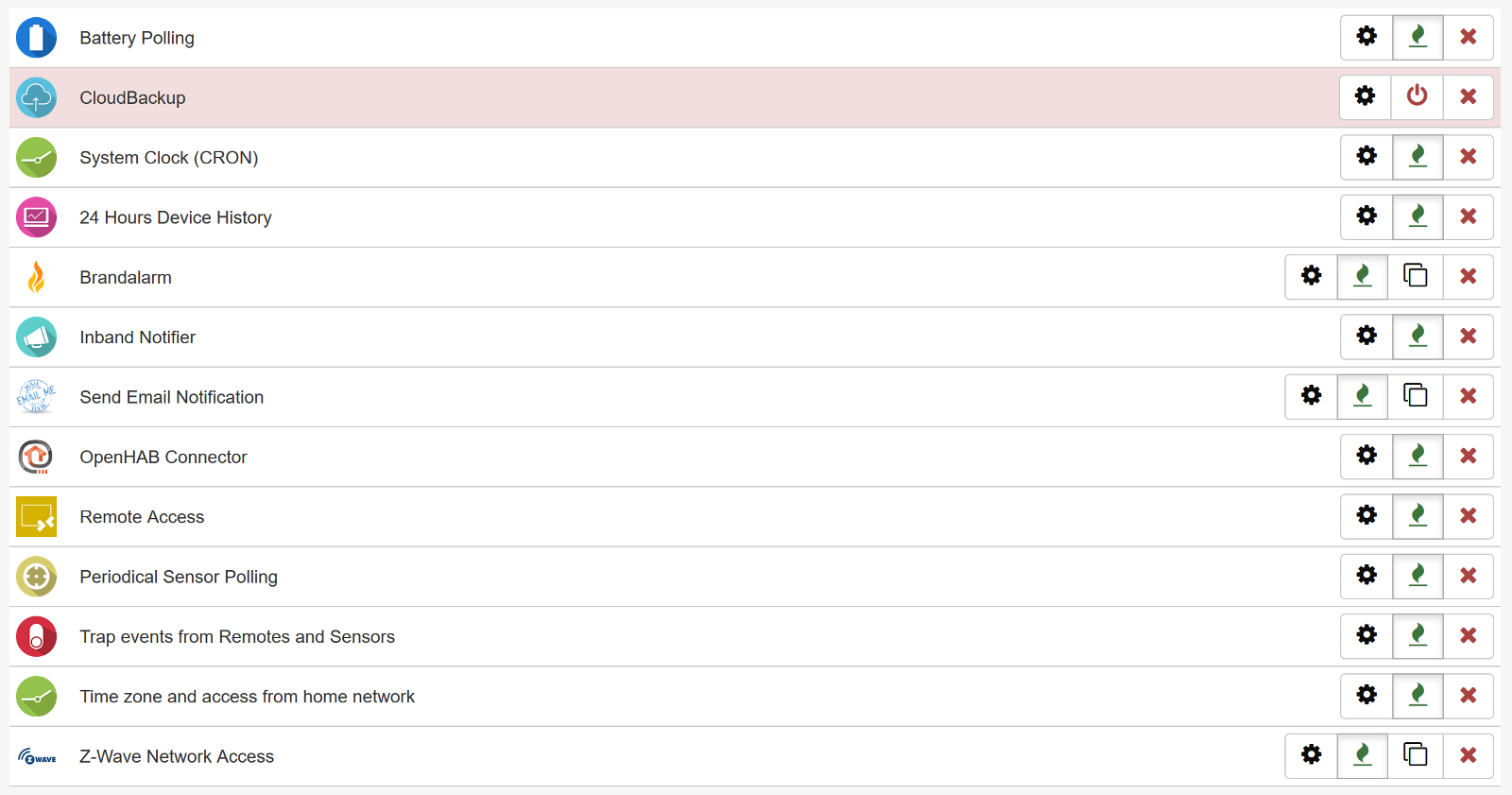

Just had to reinstall my Z-Way again last night: It's simply running the latest Raspian Jessie and Z-Way running on a RPi 3 - nothing else. The former install did the same - it lasted for around a week before I had file system corruption.
Yes, I hope so: What do you want? (I'm a professional software developer and, most of all, a DevOps).
Of course not: But it might help you to understand that Z-Way doesn't work perfectly well for all of us. And initiate a dialogue, I hope. Seems I succeeded on the latter part.Just complaining that it does not work, hang your Pi or corrupt filesystem or eat you food will not help us to make it more stable.
How do I provide that in a form useful to you?We need more I formation like detailed info about your config (what additional apps do you have), gdb traces, or other useful info.
- zway-apps.png (146.77 KiB) Viewed 16672 times
