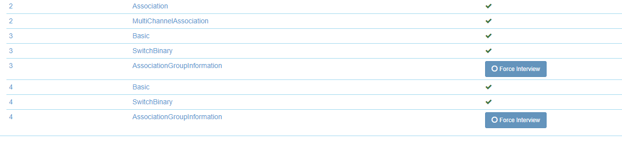

I have a problem with interview on Fortrez MIMO2+ device, interview basically stuck on 93% and two items never finished. If I go and Force to do interview manually it seems like controller is not doing anything at all, I don't see any activity in the Queue or in the log.
Device basically has 5 instances, 1 generic, 2 sensors and 2 relays, the problem is with the last to relays which cannot finish Association Group Information (0x59/89) interview, which actually supposed to be only one group "Lifeline".
Force Interview.png (9.69 KiB) Viewed 10925 times

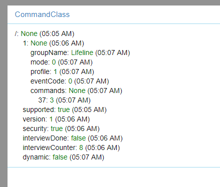

At the same time from Expert Commands I can get all the required information, no failures and I see activity in the log.
Command Class.png (17.93 KiB) Viewed 10925 times
I've attached relevant log as well, from the log I see the whole interview goes fine, reaching the end and doing the last two items but unfortunately cannot tell why it is not finishing them.
