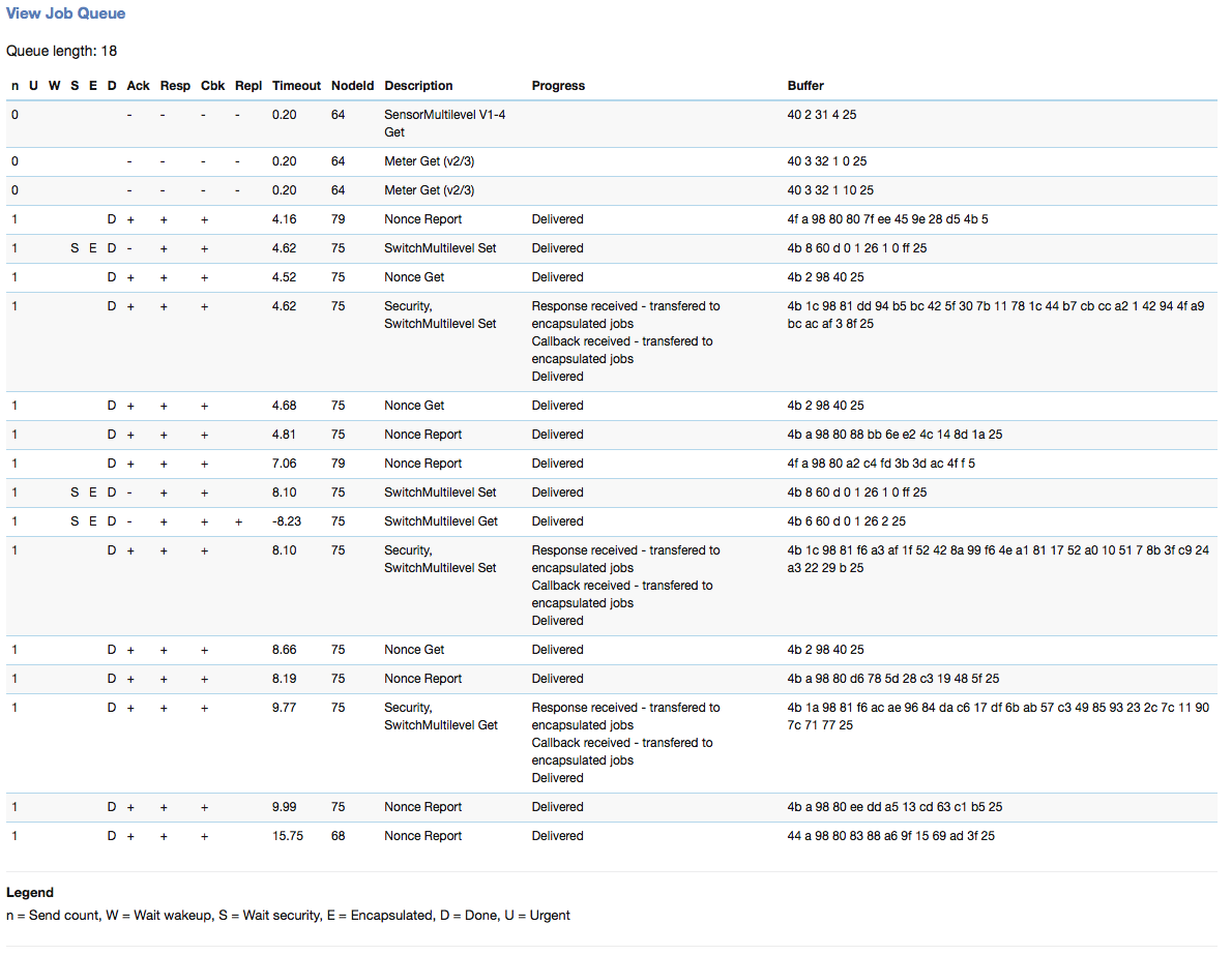

I am on v2.3.5.
The job queue varies from 3 to 20 without doing anything. See attached.
#64 is a wall plug which is currently not plugged in. So that can't be reached.
#79 is a Fibaro Magic Eye (battery powered).
#75 is a Fibaro Dimmer which was not in use at that time.
- Bildschirmfoto 2017-10-03 um 12.38.13.png (875.45 KiB) Viewed 10016 times
Re: Slow Z-Wave network or slow Z-Way server?
Only one packet to 79 (to allow him to report us the value) - this looks ok
Many packets to 75 - all of them are related to a send operation (set dimming level - something is instructing the gateway to send them).
And 68 (some other device) also reports us something.
