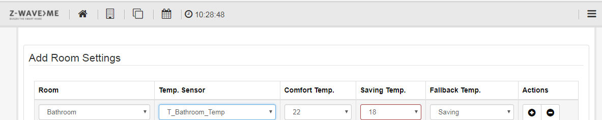

There is a bug in Climat control app - temperature sensor name is not being saved (after Saving and reentering configuration page field is empty).
App version: 1.1.4 stable
Firmware version: v2.3.6
UI version: 1.7.1
Built date: 28-09-2017 15:29:18
Capabilities: Slm

This is a bug, in the UI of the App. This will fixed with the next Version of the App.
The sensor is set, but you do not see it.
