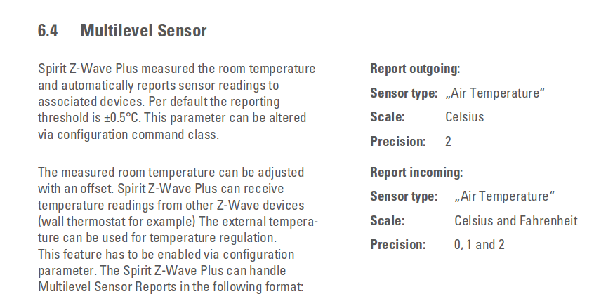

I want to input a median temperature to the spirit, meaning I want to take the output of the mathematica module which does some magic to a couple of values and feed it into the spirit.
Bildschirmfoto vom 2017-11-08 21-55-43.png (59.19 KiB) Viewed 10544 times
Can anyone help me, how I can use any given mathematica value to direct a multilevel_sensor value to the spirit? I am well aware that this would only work if the razberry is operational but I am willing to make that sacrifice.

My average Room Temperature influences the thermostat in some way, but not a good one. In the room where I tried out the virtual thermostat, the thermostat keeps on heating even if the target is set to something around 18°C and temperature reached 24°C. As soon as I disable the external temperature by setting the parameter 8 to 0, the valve is being closed and proper operation resumes. So Virtual Thermostat does something but not what I presumed what it would do.
Eurotronic Support told me that the spirit requires MULTISENSOR_SENSOR_REPORT, Type "Air Temperature". How can I check what reports are being sent to the spirit? Can I set up a debug trace to better understand what's happening or not happening?
