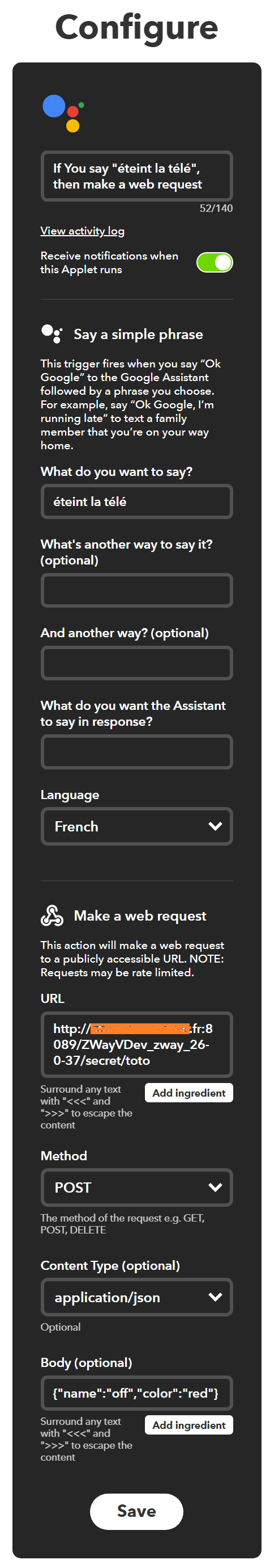

Hello, i send my authenticate params directly with my command action in my node script. I do this for my google home.
you can see what my ifttt applet look like in attachment.
http://xxxxx.fr:8089/ZWayVDev_zway_26-0-37/secret/toto
{"name":"off","color":"red"}
ZWayVDev_zway_26-0-37 -> zway identifier
toto -> secret key
"name":"off" -> zway action (on or off)
toto -> secret key
Sorry my work is in progess and actually i'm not an expert in node js and i need some help to do a good tutorial. and i need to clean up my code
To do my script i fork https://github.com/kamikat/tttfi and i add ZAutomation/api
