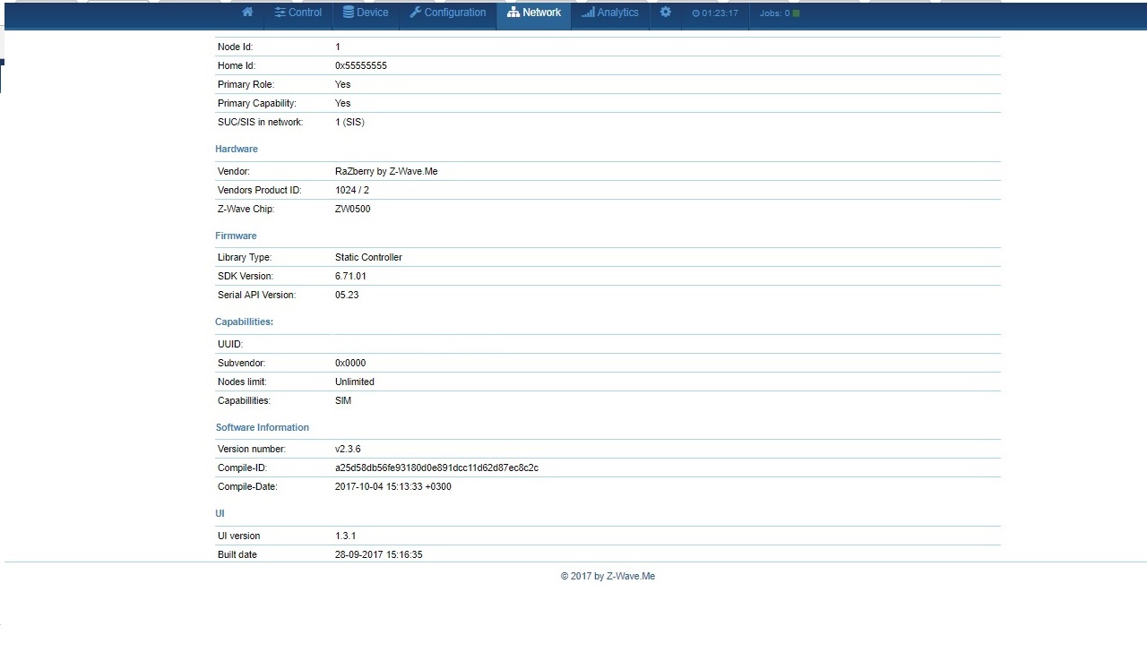

If the problem is still valid, please show us controller info page in Expert UI and logs.

Oh, your Home ID.... Please follow the guide here:
http://razberry.z-wave.me/index.php?id=29 (see section RaZberry can include and exclude devices, but they are all marked as dead immediately)
