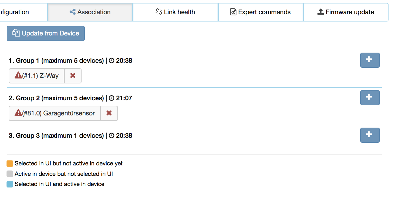

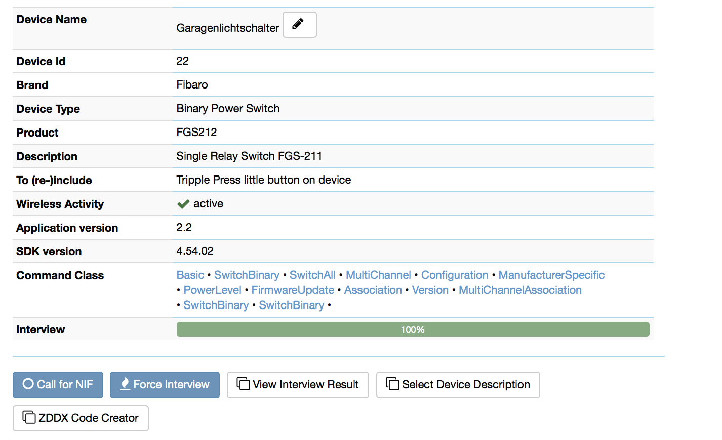

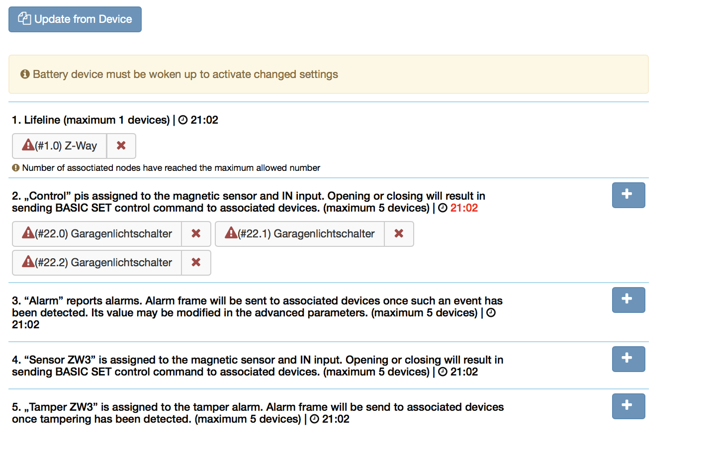

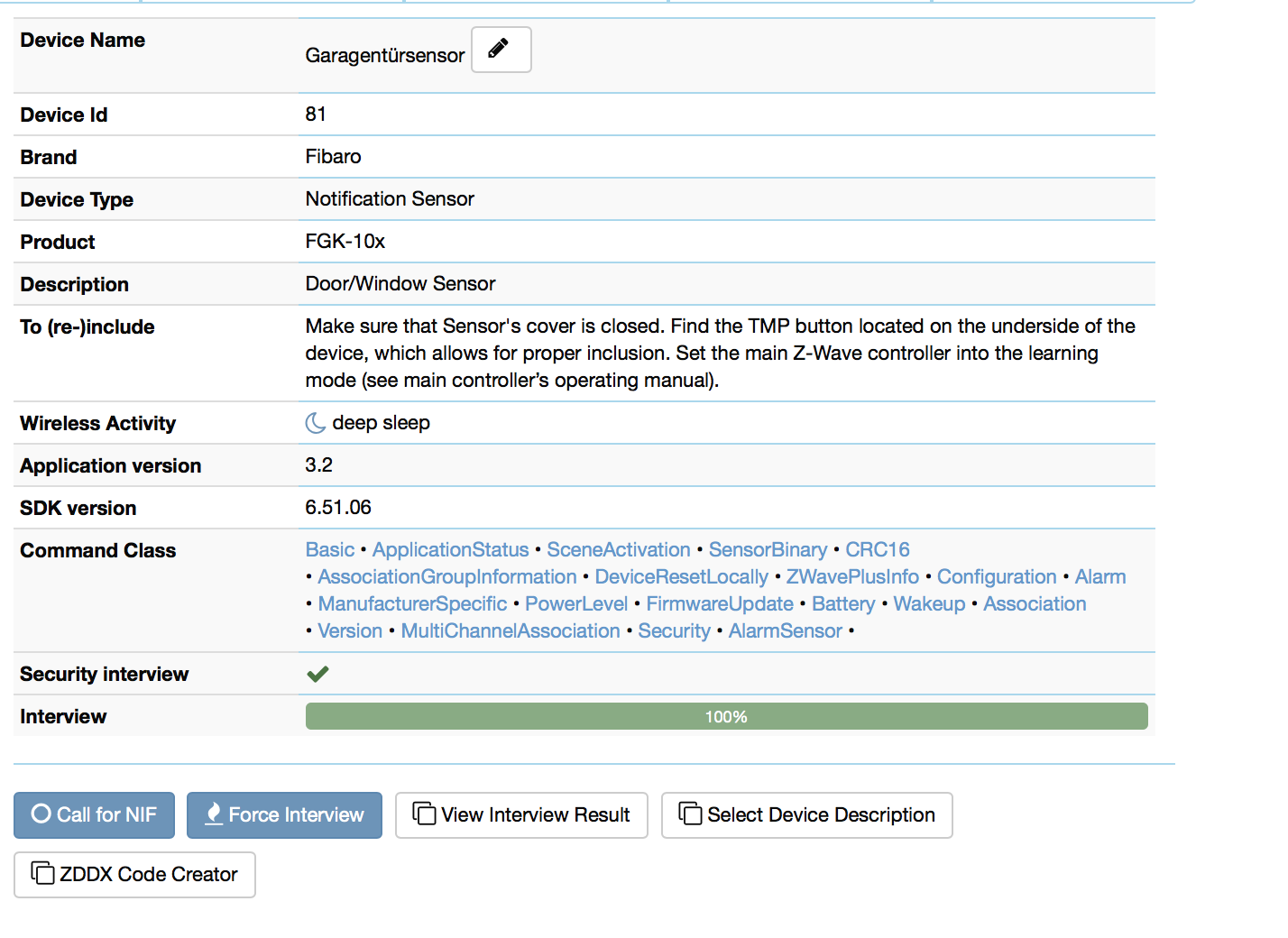

Hi, I found a strange behaviour don't really see the reason why it happened and more importantly, how to solve it.
Among lots of other modules, I have one Fibaro Window/Door Sensor and a Fibaro Switch.
I always had a direct association between both, so, that light goes on, if the sensor send basic signal to group 1 of the switch.
(see screenshots).
Both devices are associates and can also directly communicate. Link health is green. (Distance is around 2 meters.) and zwave-central maybe 5 meters away.
I ex- and re-included the sensor already completely, and the sensor is working (e.g. showing status updates in smarhome UI, when I open/close door).
Just the light from the switch is simply not getting triggered.
Someone having ideas, where else to look?

I just noticed, that another still existing association between a fibaro eye and the switch still works. So basically the switch is able to listen to those.
Just ignoring them from door sensor?

Both device must be included in secure or unsecure mode.
