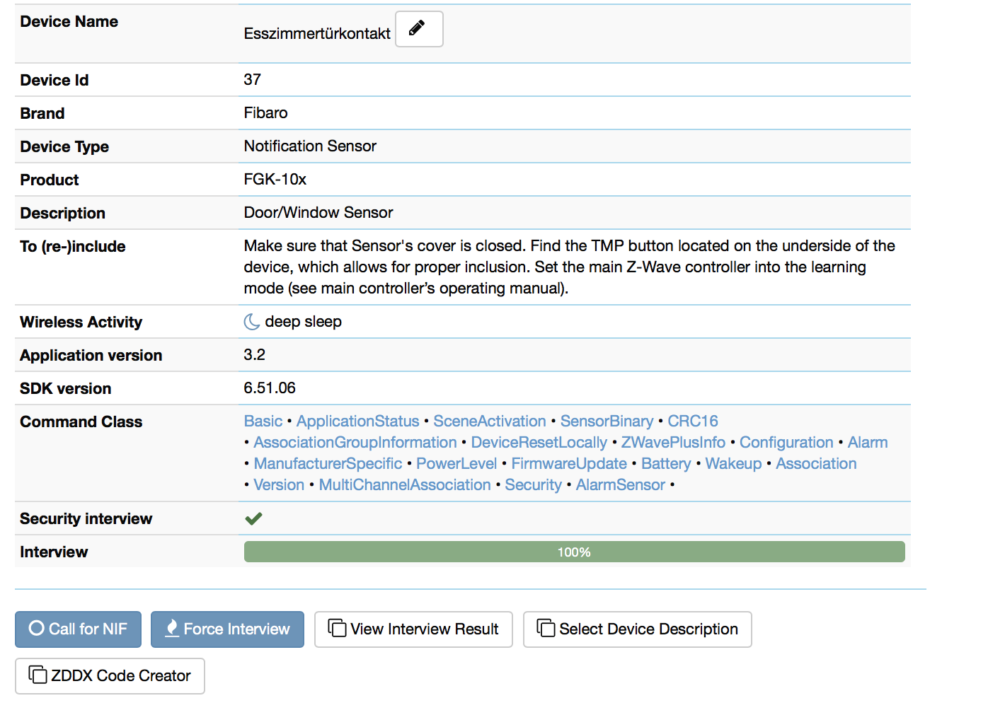

Hi I have (at least) one Fibaro Door/Window Sensor, that is included properly and interview is also 100% fine. The device is also reachable indirectly (more than 1 hop).
What I found strange is, that no event in the UI is emitted if I open/close the door e.g. forcing a switch.
But the zway-log is receiving something. (see log below)
Ideas?
