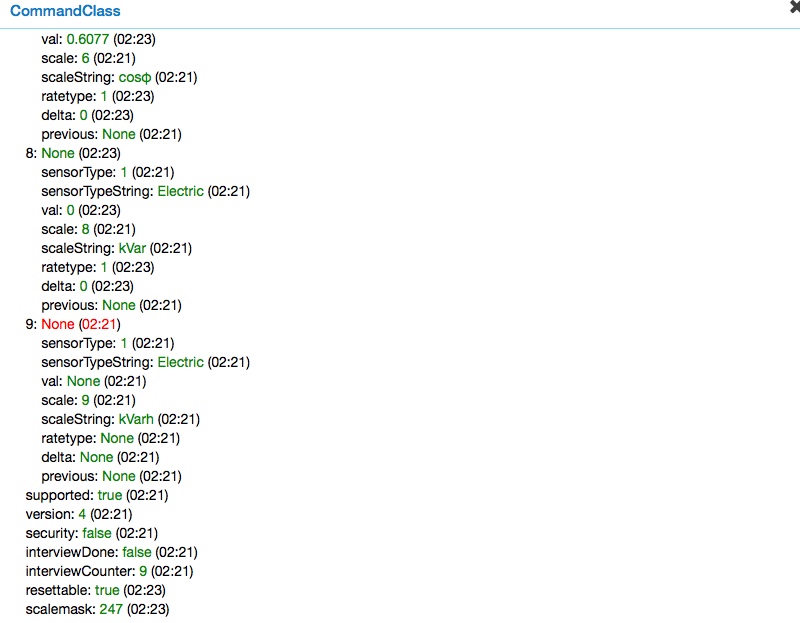

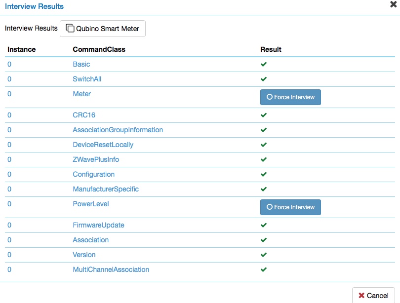

ok, updated to 2.3.6 but the Qubino smart meter failed the interview at 99% during inclusion. I have tried to remove the device and reinclude it but now all meters are not shown in the interface. Tried to force interview in expert user it stuck at 86%.
What can i do?

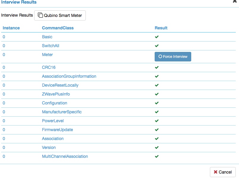

Here the interview result:
Re: Qubino smart meter problem
This is known and solved in v2.3.7-rc2. Please give it a try

with 2.3.7 rc2 same thing: during inclusion it stop to 99% of the interview.
If i go to interview result, now only the command class "meter" is not complete.
