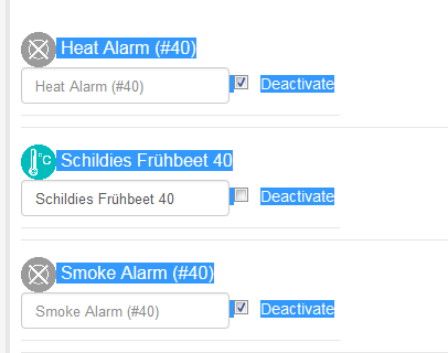

I assume that this may be caused by the transmitions from this device?!
It´s a Fibaro smoke sensor FGSD-002 where i disabled all functions except temperatur. So far it worked and I only get the
temperatur report and just this device in Z-Way.
