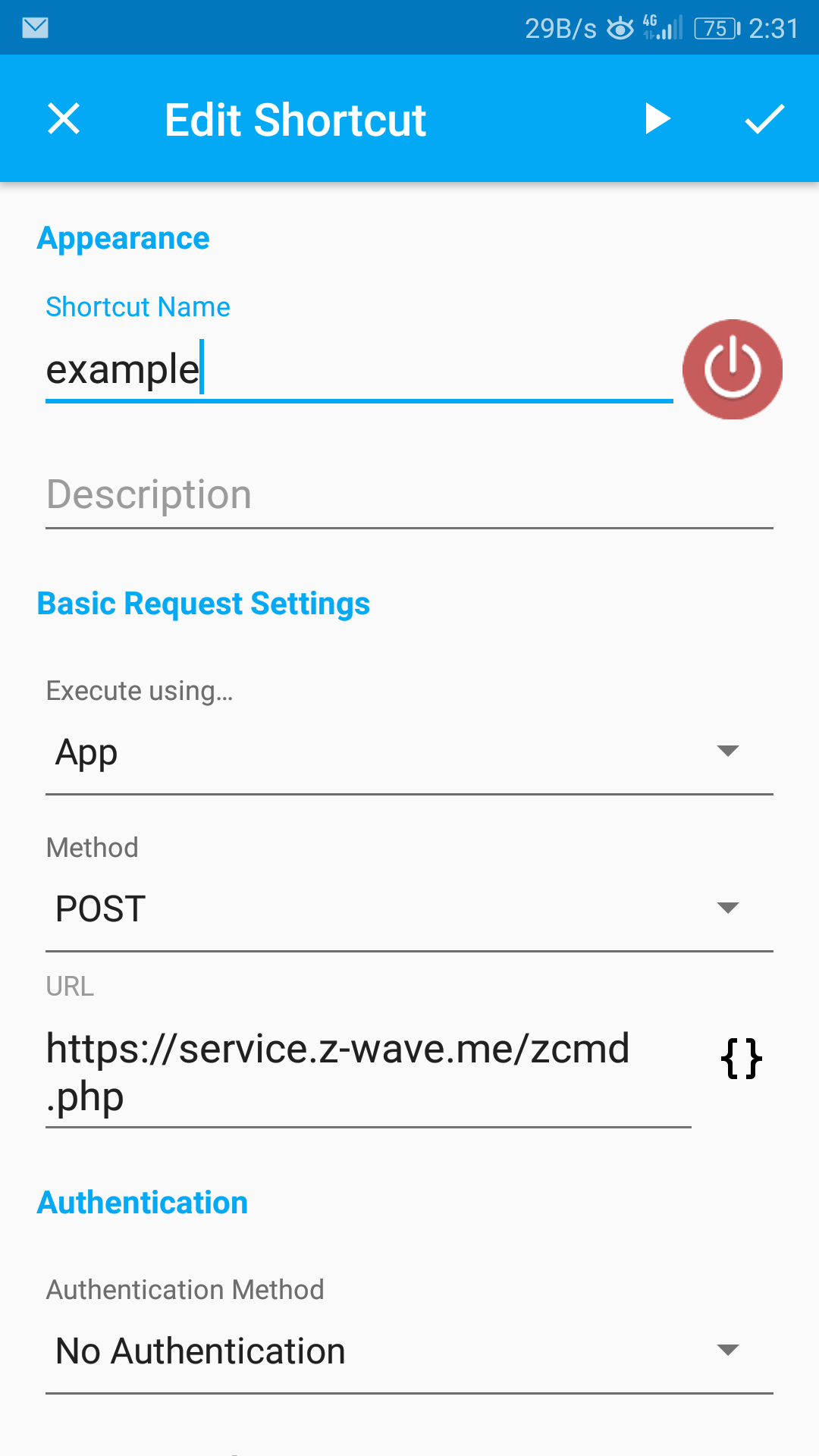

You can still do it using find service.
There is even an example of zcmd.php helper that can help to pass find.z-wave.me authentication.
You can use things like this from your Android using HTTP Shortcuts app.
The attachment Screenshot_20180613-023119.png is no longer available
