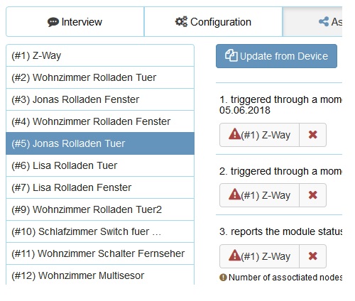

Re: Version 2.3.7 -buggy or not?
Posted: 16 Jun 2018 10:25
by ibins30
i think all associations should be correct
The attachment Association.jpg is no longer available
but when I Push a button
The attachment Push Button.jpg is no longer available
I have to do push on the update button, or
have an App poll for every 30 Minutes
Any help woul be appreciated.
Thanks
ibins30
