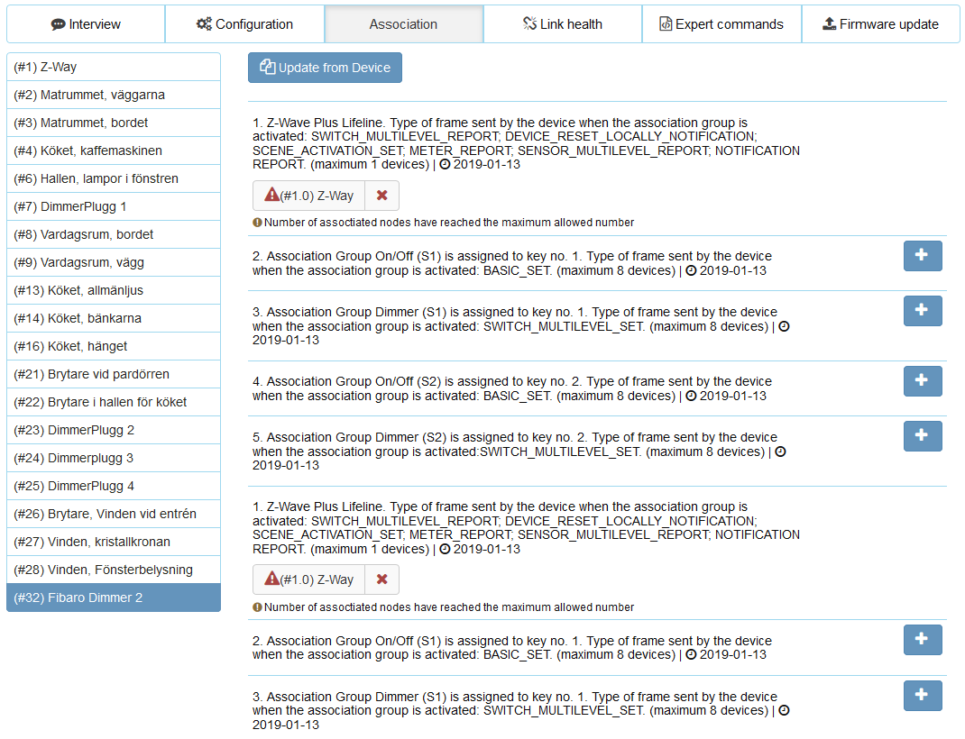

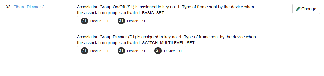

Before including the WallMote, I needed to remove the associations I created during the test. It turns out that this is not doable in the expert UI. I open Device and Active associations and find the associations listed for the Fibaro device. Clicking "Change" only leads me to the Association page for the Fibaro Device and there are no associations listed there other than the Life line associations to the Z-Way.
How do I remove associations in Z-wave.me?
Including screen shots of the UI.

Just to add to the above, it seems a bit strange that associations for devices that have been excluded (=removed from the controller) remains in the UI as is the case with device #31 above.
Trying once more to include the screen dump...
fibaro device.PNG (91.82 KiB) Viewed 15654 times

If I click the button on the right side "Change" and enter the Expert Menu, there is nothing shown. Only the Z-Way lifeline....

Hi Polto, did it, nothing to see or to do. I also can´t set a new association, as the device 10 isn´t shown in the menu.

[tag]PoltoS[/tag] "Gonin Configuration/your device/associations" does not help at all, the associations does not appear there. They are shown if I go Device/Active Associations but not via Configuration/select device/Association. Does not matter if I wake up the Wall Quad or not, nothing there.
I have also tried to restart the entire Raspberry Pi - no change for the better.

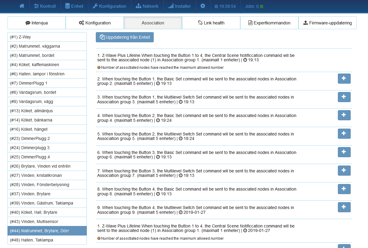

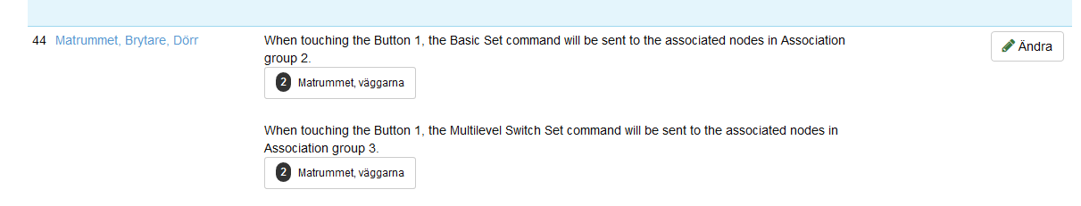

I think there is a bug in the listing of active associations. Include one example of device #44 that according to the list of active associations, have two active associations. When clicking the "Change" icon the association page for the device #44 is shown but there are no associations listed?! This seems like a bug to me.

Re: Can not remove associations in Expert UI
Posted: 03 Feb 2019 22:07
by brusan
Could not get image 2 to show up in the thread. Trying to put it here:
