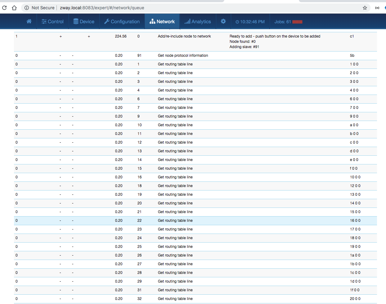

tin921
Posts: 14
Joined: 26 Apr 2019 04:59
Re: Slow inclusion on large networks
Post by tin921 »
i have the same problem. i have close to 60 devices actually. last few devices, i had to try a few times before the inclusion can complete. looking at the Job Queue during the inclusion progress, it looks like zway does a get route on all existing devices. i have to believe it has a huge impact on the 10-20 commands interview/request to the new device.
A deviceuring inclusion have to test all other devices if they are in direct range or not. This takes time if most of themte not reachable directly. Usually this is 30-40 seconds and then some 20-40 for interview. But if the device is far and routing is used, interview can take much longer
