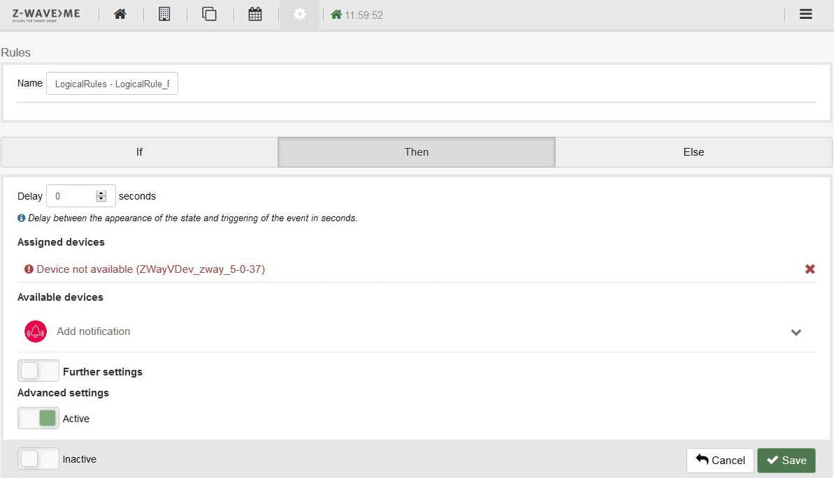

Then I wanted to change a rule (Automation -> Rules -> select a rule for modifiying). Surprisingly in Assigned conditions of IF section it showed me only "Device not available"(Advanced settings activated). There were also no devices for selection. Available are only "Time condition", "Nested condition" and "2 Device comparision".
In the THEN section it showes me "Device not available (ZWayVDev_zway_5-0-37)" (internal Z-WAY name, changed to AEOTEC Micro Switch G2).
Also no device available for selection.

Re: Rules & Scenes corrupted after upgrade to 3.0.0
We have recently found a bug in rules: if alarm devices are present, the UI shows no available devices. May be you see same case. There is a workaround and we will fix it soon
This is fixed now in the development tree.
