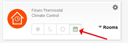

Both the Heating control and the climate control app don't seem to work. I've defined a simple schedule, e.g. 7-22 to 21°, the rest to 17°. If I manually switch from time-driven to e.g. comfort mode and back, the right temperature according to the schedule is applied, but not automatically.

did you switch the "climate control" element to "time driven" ?

yes, as I wrote " If I manually switch from time-driven to e.g. comfort mode and back, the right temperature according to the schedule is applied"
