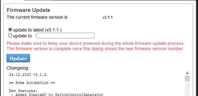

Hi Polto,
I tried upgrade from 3.1.1 to 3.1.2 with: sudo apt-get install z-way-server, but that ends with a response:
"z-way-server is already the newest version (3.1.1)." so 3.1.1. is NOT being upgraded to 3.1.2
(Also sudo apt-get update z-way-server ends with "All packages are up to date")
I have to RPi's, one running Stretch, the other Buster, with identical results.
is the something wrong with the packages?
