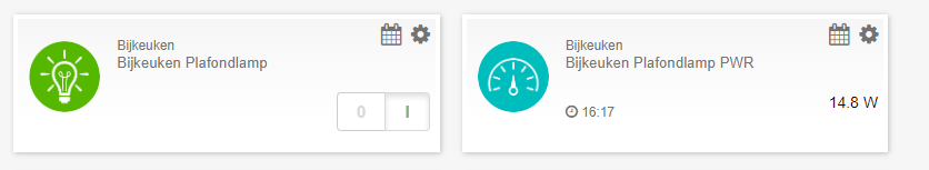

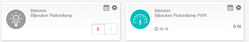

As shown in the pictures above.
When I "power on" a device, the UI shows the power reading of that device at that specific moment. (20 watts for example)
When I turn the device off, that power reading goes to 0 watts, so that works.

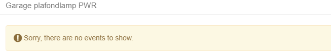

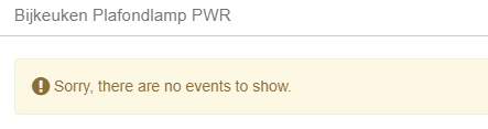

However, when I press the calendar Icon on that device it says "sorry, no events to show" while I expect it to show the power readings from the past, like with Fibaro dimmer devices.

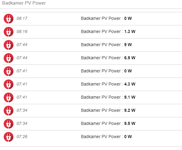

to make it even more clear maybe, here is 2 screenshots, expected and not expected.
NotExpected
Expected
