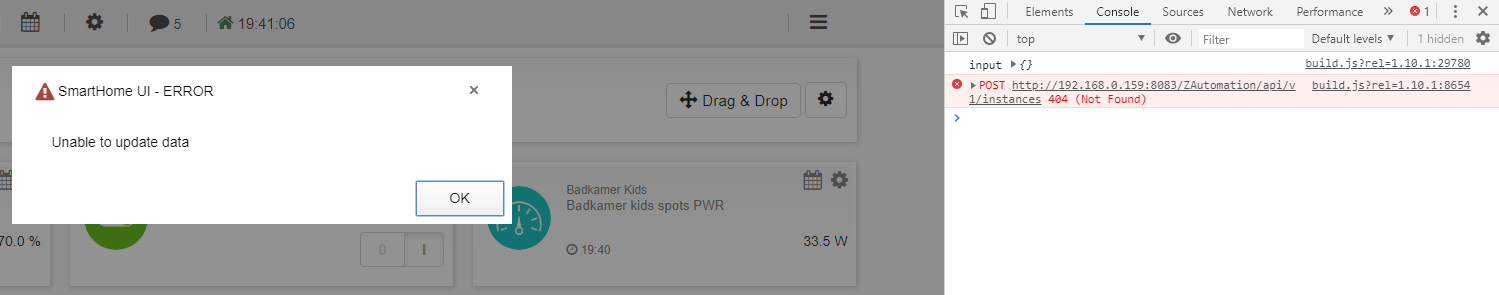

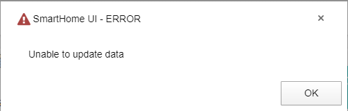

On almost every change I do on a device (add a tag for example) and then press "Save" , I do get the error message as below:
The change is however saved, do look like cosmetic error but should not be there I think

I have the problem as admin as well.
Error from browser console log is :
build.js?rel=1.10.1:8654 POST http://192.168.0.159:8083/ZAutomation/api/v1/instances 404 (Not Found)
Re: Smarthome UI error
Can we access it to reproduce? Have you checked the Google Assistant/Alexa checkboxes in device settings? Can you uncheck them?
