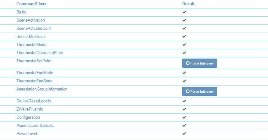

Hi Guys,
I have a problem adding GoControle thermostat GC-TBZ48L and alarm.com thermostat into my z-wave network. All the command classes pass the interview but ThermostatSetPoint!
Can you please help me resolve it!
Thanks

Re: Interview errors for ThermostatSetPoint Command Class with both GoControl thermostat and alarm.com thermostat
Posted: 12 Feb 2020 20:36
by jalalsinisaz
This is also the log of another thermostat:
Posted: 13 Feb 2020 03:22
For me the device looks as buggy - it do not reply to some commands and reply with corrupted packets on some others. Please contact the manufacturer and show them those logs - they should be able to fix the issue
