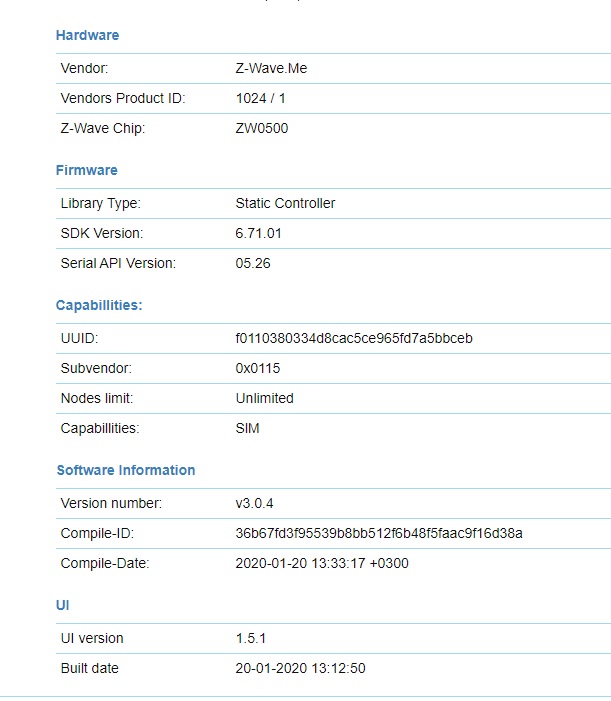

I'm confused about versions and everything, that "map" is not helping either.
I'm running this, Am I on a good/latest version for my UZB controller ?
