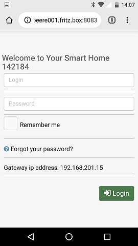

When I log in to SmartHomeUI I always set the “remember me” checkbox but this never works as I expect. After restarting the computer or turning wireless LAN off and on on a smartphone I’m in a new session and it always asks again for credentials.

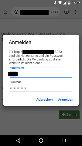

In case these credentials are saved in google chrome browser it gets even more annoying because an extra window for authentication pops up which does not work. In picture no. one this window with the stored credentials can be seen.
When I tap on login it just gets me to the plain login page where I have to put in the credentials again, see picture no. two.

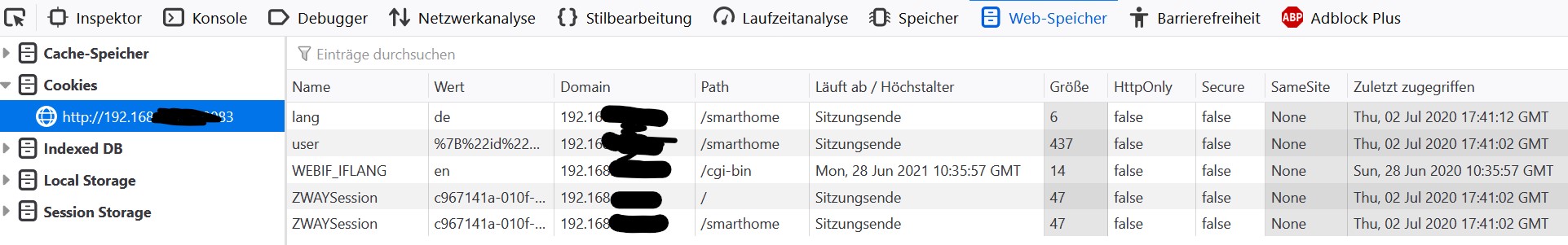

May be it clears cookies?

I observe this problem on three different android smartphones, on my windows desktop PC and on the raspberry pi itself.
The only situation in which I delete browser cache and cookies is after an update of z-way.
I also payed attention to only use one user on one device. There are no multiple users logging in from the same device.
