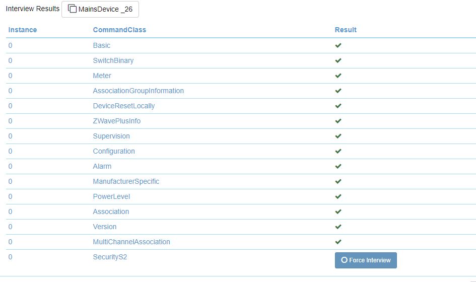

I'm trying to switch over from vera to Z-wave.me, have a PI 4b running with the z-wave-me RPi board.
I have an issue with trying to get my NEO cool Power plugs to work, it seams like then are stuck in the "interview" at 93%
What am I dooing wrong ?

If you are the same cokeman as on the vera forum and if you are moving your network from a vera, the problem here seems like the S2 security which you cannot interview because the vera never included the device securely... since it does not support S2 security. This is one of the rare case where you would have to exclude and reinclude the device so that it can be included with S2 security.

Well not completing interview is not a problem on z-way. The device will work just fine. Here it is not completing because you included insecurely. You can clearly see from your screenshot that the one failing command class is the S2 Security...

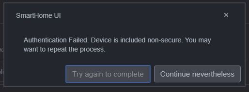

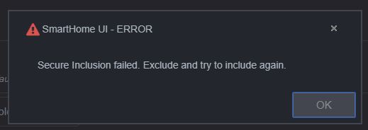

Just tried again, with a another new NEO power plug, and tried to include it securely.
After that I had to exclude it, and include it un-securely. and again, the "interview" shows the
But I trust you when you say, that it not a problem. ;) (Just don't like it when it does not show 100% complete) :shock:

On not being 100% interviewed: Some will be that way by design. I have the example of the aeotec Smartdimmer 6 Which when included without security shows instances 0,1 and 2 with all being dimmer and 2 having a color control. Which is not documented and strange and it would only miss a couple of command classes, mostly security so I would be 90%. If I include it securely then it behaves correctly with all the right command classes, eliminating all the fake ones and shows as a single dimmer and single color control. Instances 1 and 2 would not report anything: If you interview any of their command classes, the device will ACK and not send back anything. So I am now at 65% interviewed but it is correct.
In your case, your device may claim to support S2 but the firmware may not have been fully implemented and maybe the developers gave up on it and only left it in the device info.

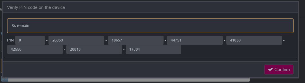

@cokeman You need to enter the PIN code in the first field. You are using a dark skin where you have hard to distinguish fields to enter from read-only fields. Here the first (with 0) is to fill, others are read-only.
