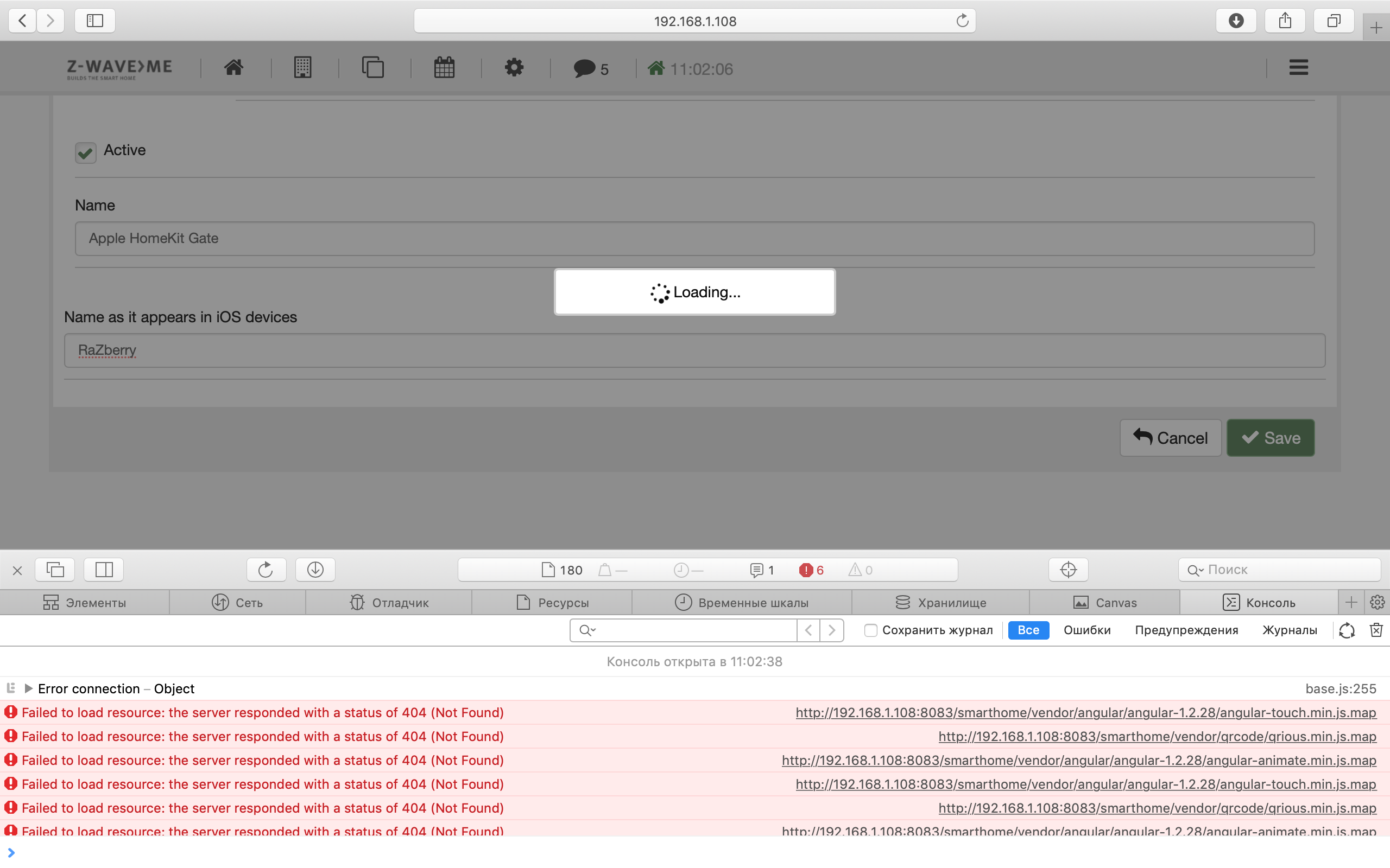

- Bildschirmfoto 2020-04-13 um 09.00.43.jpg (77.95 KiB) Viewed 10579 times
Re: Problem with Homekit App after update 3.0.5

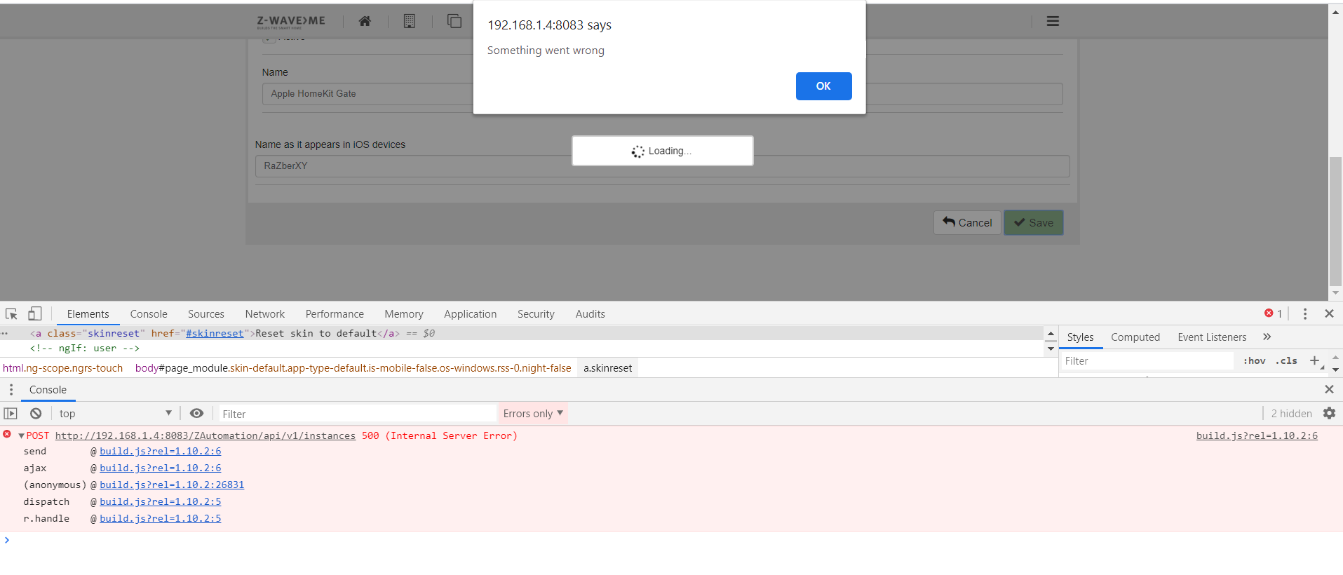

Try with another name, RaZberry1
Done that, same result!

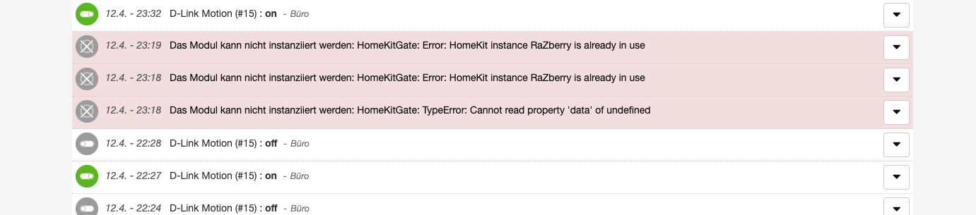

- Bildschirmfoto 2020-04-13 um 13.15.14.jpg (23.37 KiB) Viewed 10553 times

Press Save button in HomeKit Gate and show JS error in browser console.
