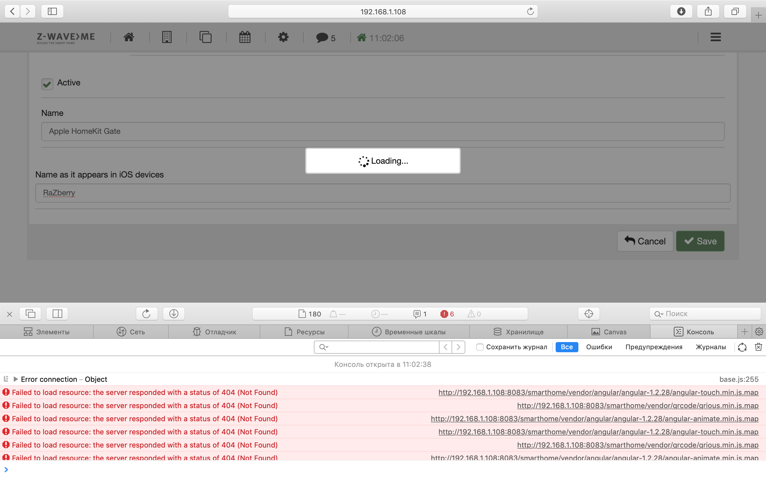

Re: Problem with Homekit App after update 3.0.5
Posted: 24 Apr 2020 11:05
by aivs
Press Save button in HomeKit Gate and show JS error in browser console.
