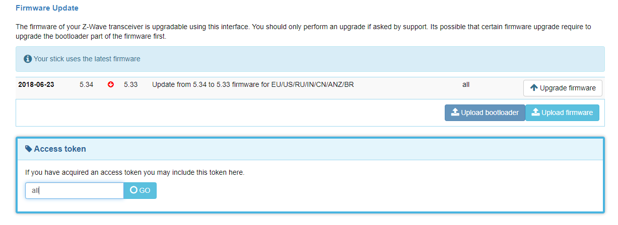

Why does the updater there not offers the 05.36 Version to me? Only a downgrade would be possible like you can see on the picture:

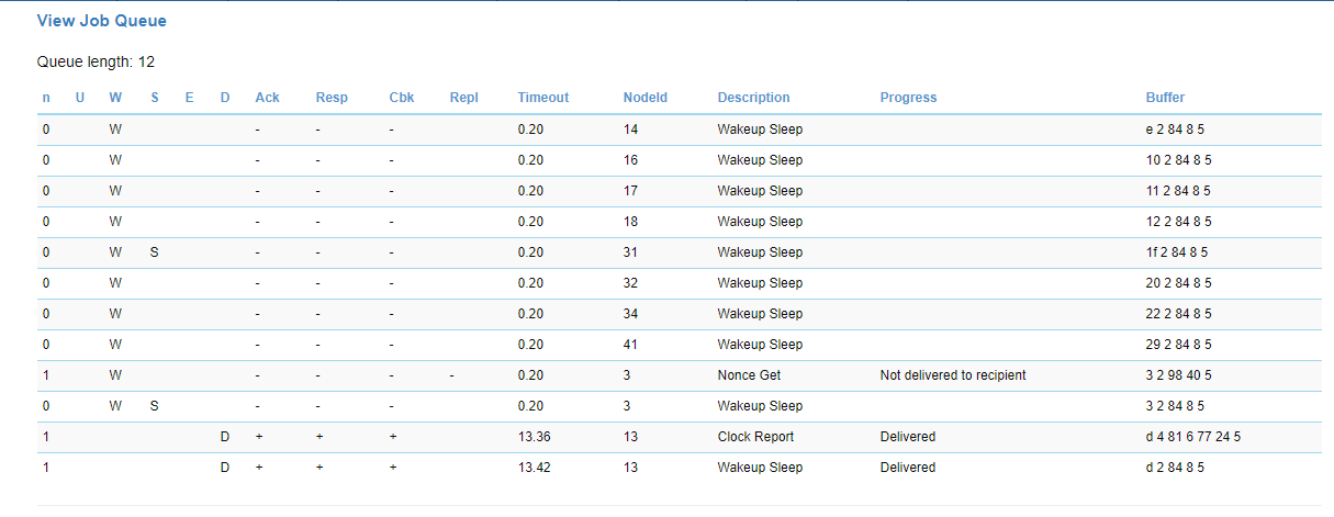

What could be the reason for such a great data traffic over the UZB controller. The controller queue shows this:

If you look here (https://service.z-wave.me/expertui/uzb- ... ith_hidden) you will see that for somewhat reason 5.34 have no switch to 5.36, but you can go back to 5.33->5.27->5.36

The queue is okey, this was discussed during the webinar, W flag is normal especially after Z-Way restart.

Thanks PoltoS. Update worked. The update grafik is really crazy. :)

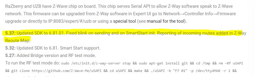

Today I was lucky to see that a new UZB firmware version is out:
How can I switch to this version from 5.36? The only offered version in the expert menu is a downgrade to 5.27. I tried the downgrade in the hope to upgrade from 5.27 to 5.37. But only again upgrade to 5.36 as the newest version.

A) 5.37 is out but not really out... According to https://service.z-wave.me/expertui/uzb- ... graph.html its not even in the list of options... Plotous should chime in here...
