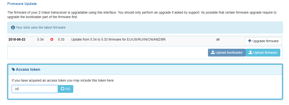

After listening today to the very interresting webinar I rocognized that my UZB firmware was quit old.
After several firmware and Bootloader updates of my UZB I am now on:
Firmware
SDK Version: 6.81.01
Serial API Version: 05.34
Why does the updater there not offers the 05.36 Version to me? Only a downgrade would be possible like you can see on the picture:
The second problem is: from the moment of ending the update process of the UZB firmware, the controller build in LED is blinking all the time without any pause? Is this normal? I dont think so. Everything seems to work normal in my system like before.

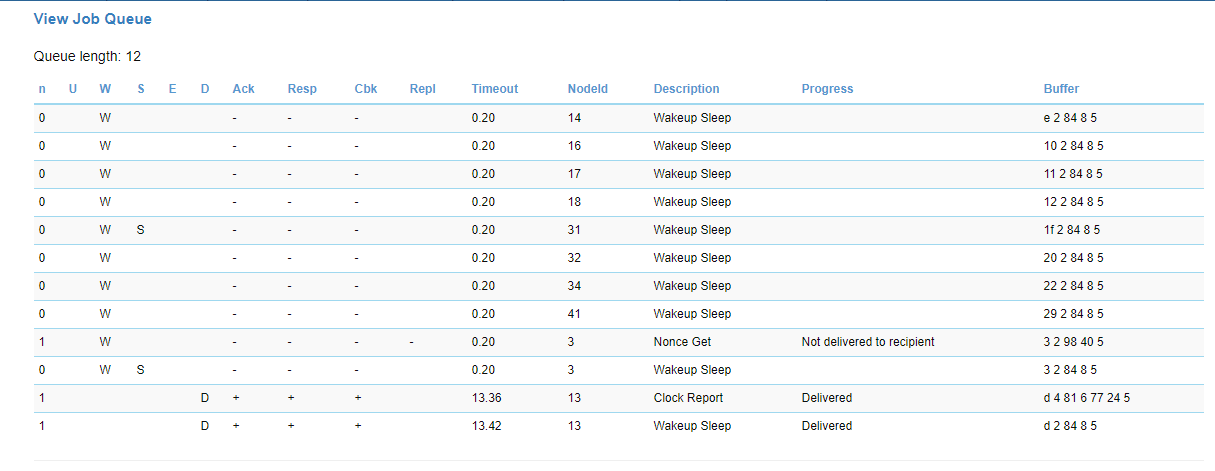

What could be the reason for such a great data traffic over the UZB controller. The controller queue shows this:

If you look here (https://service.z-wave.me/expertui/uzb- ... ith_hidden) you will see that for somewhat reason 5.34 have no switch to 5.36, but you can go back to 5.33->5.27->5.36

The queue is okey, this was discussed during the webinar, W flag is normal especially after Z-Way restart.

Thanks PoltoS. Update worked. The update grafik is really crazy. :)

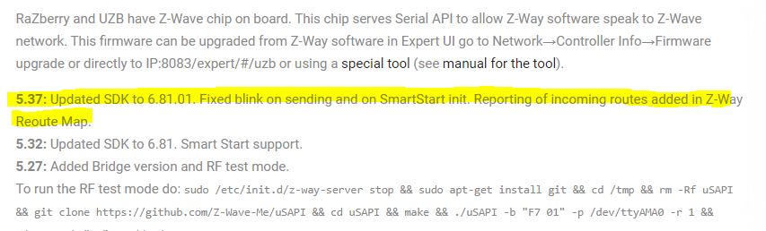

Today I was lucky to see that a new UZB firmware version is out:
How can I switch to this version from 5.36? The only offered version in the expert menu is a downgrade to 5.27. I tried the downgrade in the hope to upgrade from 5.27 to 5.37. But only again upgrade to 5.36 as the newest version.
PoltoS could you please advice how to update to the firmware with the solution to the always blinking led?

A) 5.37 is out but not really out... According to https://service.z-wave.me/expertui/uzb- ... graph.html its not even in the list of options... Plotous should chime in here...
B) The blinking appears to be a bug... Do a start inclusion / stop inclusion. I have the same behavior on 2 of my uzb sticks. Looks like it starts up in inclusion mode.
