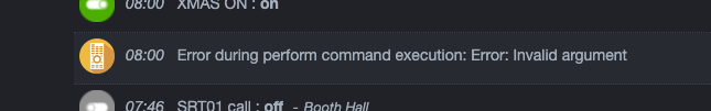

Here's the log ...
[2021-11-19 08:00:00.808] [D] [zway] SETDATA devices.2.instances.0.commandClasses.67.data.1.setVal = 20.000000
[2021-11-19 08:00:00.808] [I] [zway] Adding job: ThermostatSetPoint Set to node 2
[2021-11-19 08:00:00.808] [I] [zway] Adding job: ThermostatSetPoint Get to node 2
[2021-11-19 08:00:00.809] [I] [zway] Node 2:0 CC ThermostatMode: Thermostat Mode 1 is not supported by device (modemask 0x0)
[2021-11-19 08:00:00.811] [I] [core] Notification: error (module): Error during perform command execution: Error: Invalid argument
[2021-11-19 08:00:00.819] [I] [core] Error: Invalid argument
    at Error (native)
    at t_vDev.(anonymous function).self.controller.devices.create.handler (automation/modules/ZWave/index.js:5463:61)
    at _.extend.performCommand (automation/classes/VirtualDevice.js:376:25)
    at Schedules.AutomationModule.setNewDeviceState (automation/classes/AutomationModule.js:209:13)
    at Schedules.AutomationModule.shiftDevice (automation/classes/AutomationModule.js:329:8)
    at automation/modules/Schedules/index.js:93:9
    at Array.forEach (native)
    at AutomationController.self.runScene (automation/modules/Schedules/index.js:92:16)
    at AutomationController.EventEmitter.emit (automation/lib/eventemitter2.js:311:33)
    at automation/modules/Cron/index.js:138:27
[2021-11-19 08:00:00.878] [I] [core] Notification: device-info (device-status): {"dev":"SRT01 set","l":"20 °C","location":1}
The SRT321 gets updated despite this (which is why I haven't called it in sooner).

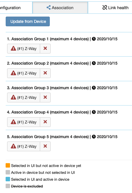

Also, what's the meaning of the warning triangles here ...
Screenshot 2021-11-26 at 12.25.05.png (64.42 KiB) Viewed 9080 times
Again, it seems to work despite these.
Re: Invalid argument error when changing thermostat value
Posted: 26 Nov 2021 17:17

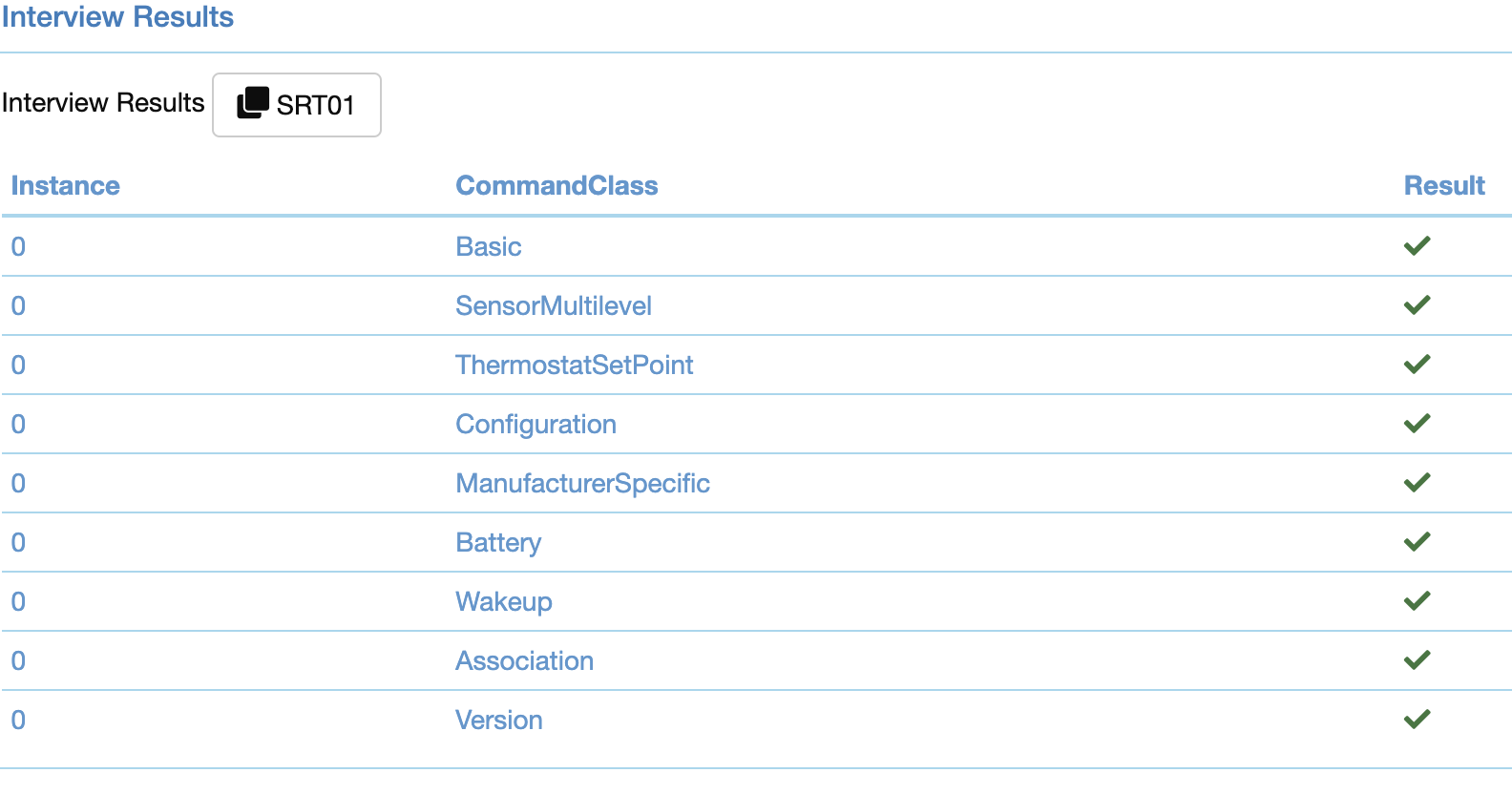

You need to force the interview of the thermostat. The thermostat reports no modes, so Z-Way is upset.
Ignore the triangles.
Posted: 26 Nov 2021 18:03
by pgdharman
26 Nov 2021 17:17
There was already a complete interview in place ...
Screenshot 2021-11-26 at 14.57.59.png (96.25 KiB) Viewed 9070 times
But, for you, I forced another interview (the wake-up required toggling switch 1 in the SRT321), and another interview completed without error.

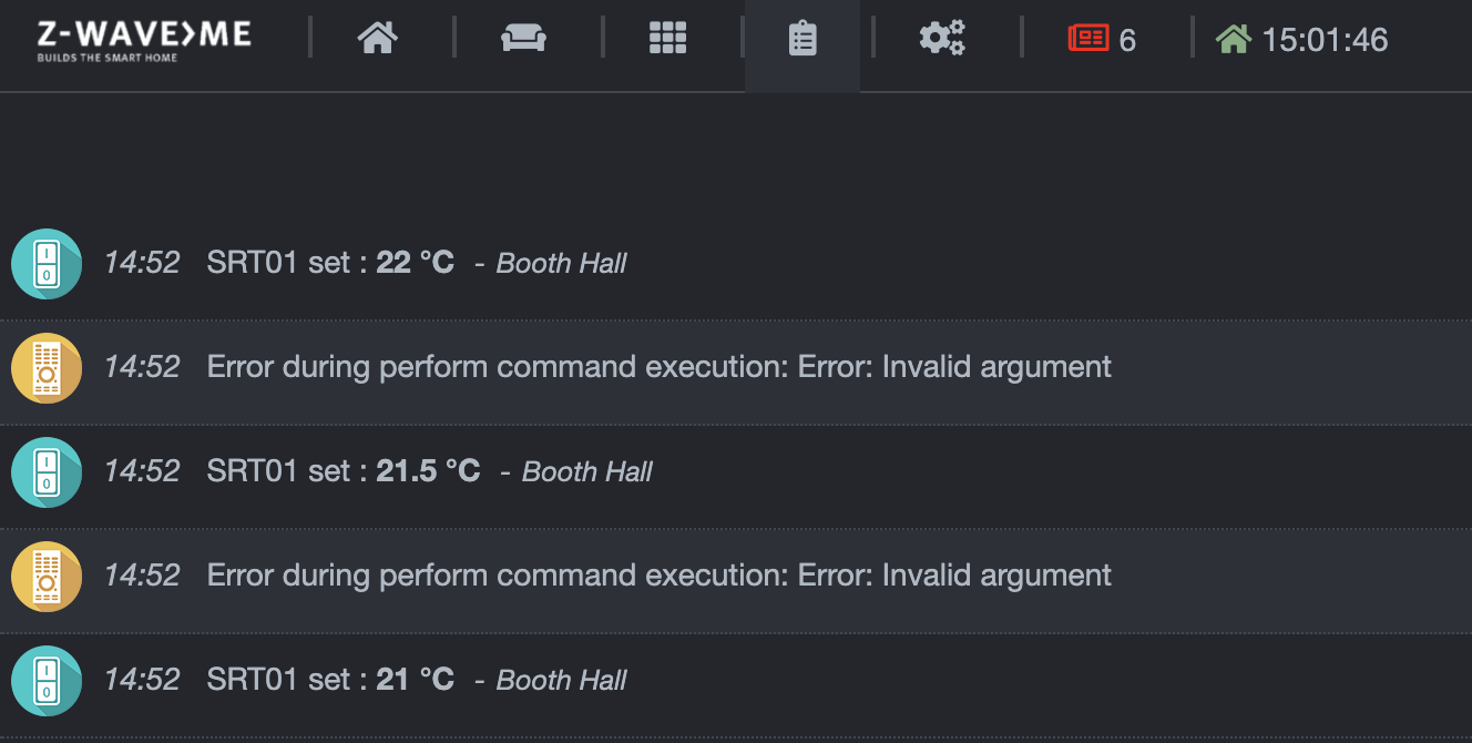

However, when I set the temperature in the Smart Home UI, I still get the same errors in logs ...

[2021-11-26 14:52:20.302] [I] [core] ---  ZWayVDev_zway_2-0-67-1 performCommand processing: {"0":"exact","1":{"level":"21.5"}}
[2021-11-26 14:52:20.303] [D] [zway] SETDATA devices.2.instances.0.commandClasses.67.data.1.setVal = 21.500000
[2021-11-26 14:52:20.303] [I] [zway] Adding job: ThermostatSetPoint Set to node 2
[2021-11-26 14:52:20.303] [D] [zway] Job 0x13 (ThermostatSetPoint Get): removing duplicate
[2021-11-26 14:52:20.303] [I] [zway] Node 2:0 CC ThermostatMode: Thermostat Mode 1 is not supported by device (modemask 0x0)
[2021-11-26 14:52:20.308] [I] [core] Notification: error (module): Error during perform command execution: Error: Invalid argument
[2021-11-26 14:52:20.327] [I] [core] Error: Invalid argument
    at Error (native)
    at ZAutomationAPIWebRequest._.extend.performVDevCommandFunc (automation/ZAutomationAPIProvider.js:439:51)
    at ZAutomationAPIWebRequest.handlerFunc (automation/ZAutomationAPIProvider.js:3977:30)
    at ZAutomationAPIWebRequest.ZAutomationWebRequest.handleRequest (automation/WebserverRequestRouter.js:250:35)
    at WebServer.document_root (automation/Webserver.js:39:31)
[2021-11-26 14:52:20.344] [I] [core] Notification: device-info (device-status): {"dev":"SRT01 set","l":"21.5 °C","location":1}
[2021-11-26 14:52:20.594] [D] [zway] Job 0x13: deleted from queue
[2021-11-26 14:52:20.819] [I] [core] ---  ZWayVDev_zway_2-0-67-1 performCommand processing: {"0":"exact","1":{"level":"22"}}
[2021-11-26 14:52:20.820] [D] [zway] SETDATA devices.2.instances.0.commandClasses.67.data.1.setVal = 22.000000
[2021-11-26 14:52:20.820] [I] [zway] Adding job: ThermostatSetPoint Set to node 2
[2021-11-26 14:52:20.820] [D] [zway] Job 0x13 (ThermostatSetPoint Get): removing duplicate
[2021-11-26 14:52:20.821] [I] [zway] Node 2:0 CC ThermostatMode: Thermostat Mode 1 is not supported by device (modemask 0x0)
[2021-11-26 14:52:20.822] [I] [core] Notification: error (module): Error during perform command execution: Error: Invalid argument
[2021-11-26 14:52:20.829] [I] [core] Error: Invalid argument
    at Error (native)
[2021-11-26 14:52:20.834] [I] [core] Notification: device-info (device-status): {"dev":"SRT01 set","l":"22 °C","location":1}
26 Nov 2021 17:17
I'm not sure if this translates, but in our culture we have the story of the little shepherd boy who shouted "Wolf! Wolf!" even when he was lonely, and there was no wolf. Eventually, the villagers didn't take any notice, and when a wolf did appear, the didn't come, and the boy perished ;)
