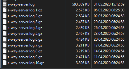

Hi there,
on 6. may i updated my z-way server from 3.0.5 to 3.0.6. Everything was fine...
Today i took a look at the logs in /var/log/
See the attached pic for result. The actual log has grown...hm...very very big. :?:
And there is also no backing up the logs after three days. :?:
After a reboot the log stays that big.
It is a bug?
Cheers Nordstern

Yes is a bug that was fixed in 3.0.2, but came back in 3.0.6
This command will fix it for 3.0.6
sudo chmod 0644 /etc/logrotate.d/z-way-server
Wait 1-3 days for it to work, or run it now with this command :-
sudo logrotate --force /etc/logrotate.d/z-way-server
