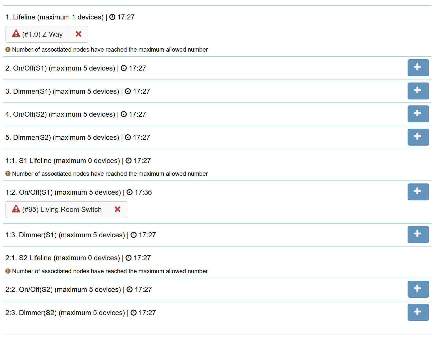

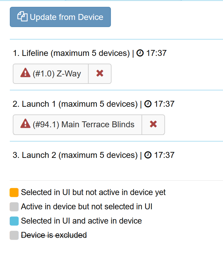

Hello everyone,
I am relatively new to the Z-Way / Z-Wave world and I am trying to control a Fibaro Double Switch (which is controlling some blinds) using a simple wall Switch (HeatIt). I have tried all possible combinations of creating the association between these two devices, but none of it seems to work. I also tried looking for a general tutorial regarding associations, with no luck.
I hope you can help me out. I have attached some screenshots - is the Red Exclamation Mark sign of a problem?
Thanks.
Alex

Hi, the exclamation mark isn´t a problem, it´s normal.
You should set the association on your heatit wall switch. Maybe it´s a problem with your fibaro and the dimmer settings,
don´t know which group the fibaro supports.
In case of hiting a button on the wall switch it will send a command directly to the fibaro. This maybe a notification or another
command.
