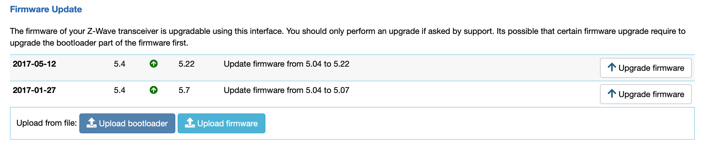

Hi, it should be the german frequency. I will try to update the firmware. Should I update the firmware step by step? See attachment, please.
Re: Failed to include new Fibaro devices after update to 3.1.0
wow, pretty old. do 5.7->5.23->5.32->5.36->5.39
But the questions was not to push you update but more to know if the frequency is correct - after upgrade from old firmwares it falls back to EU (Germany is using EU, so ok for you)

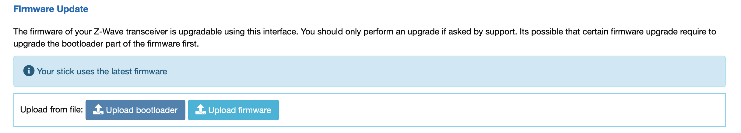

Hi, the update is done. There are no more updates available you mentioned.

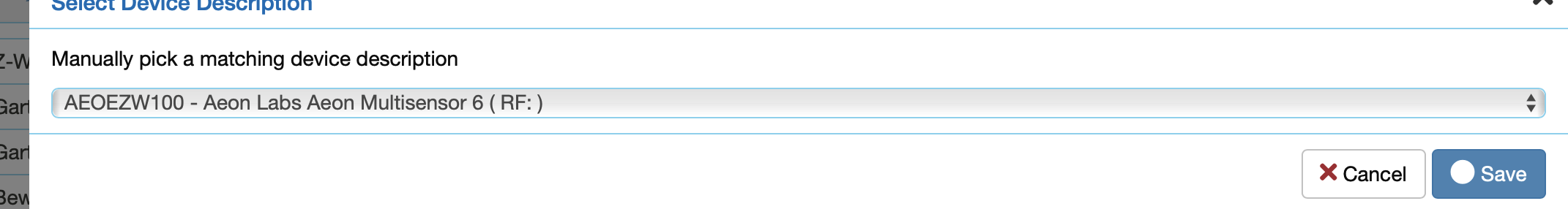

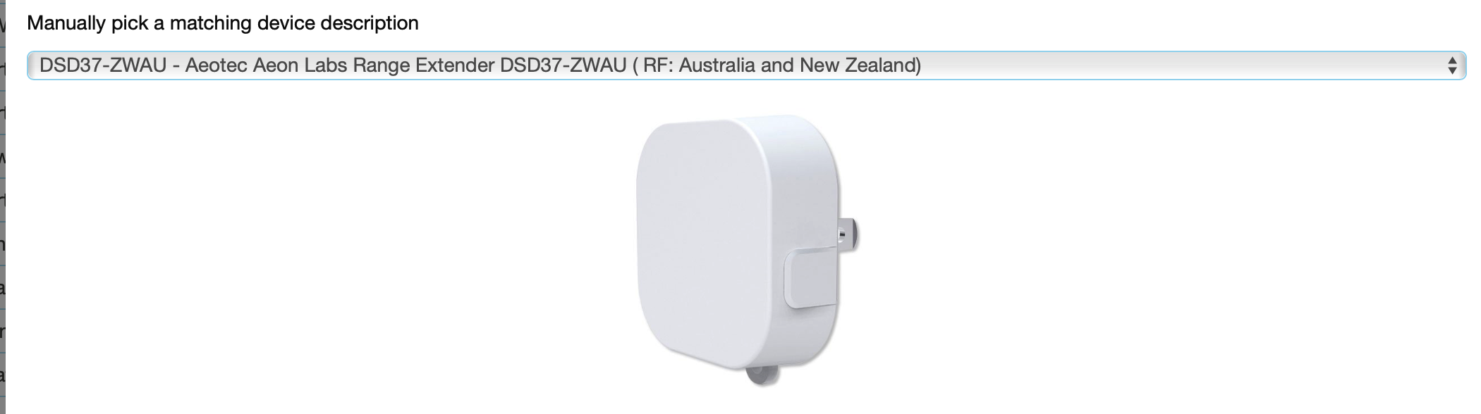

I figured out one more problem. When I try to select the device description in the experience UI, the device is not available. I did the "Update the device database" several times. It is an Figaro Roller Shutter FGRM222 (EU).
You can just use Detect automatically. No need to select this description
