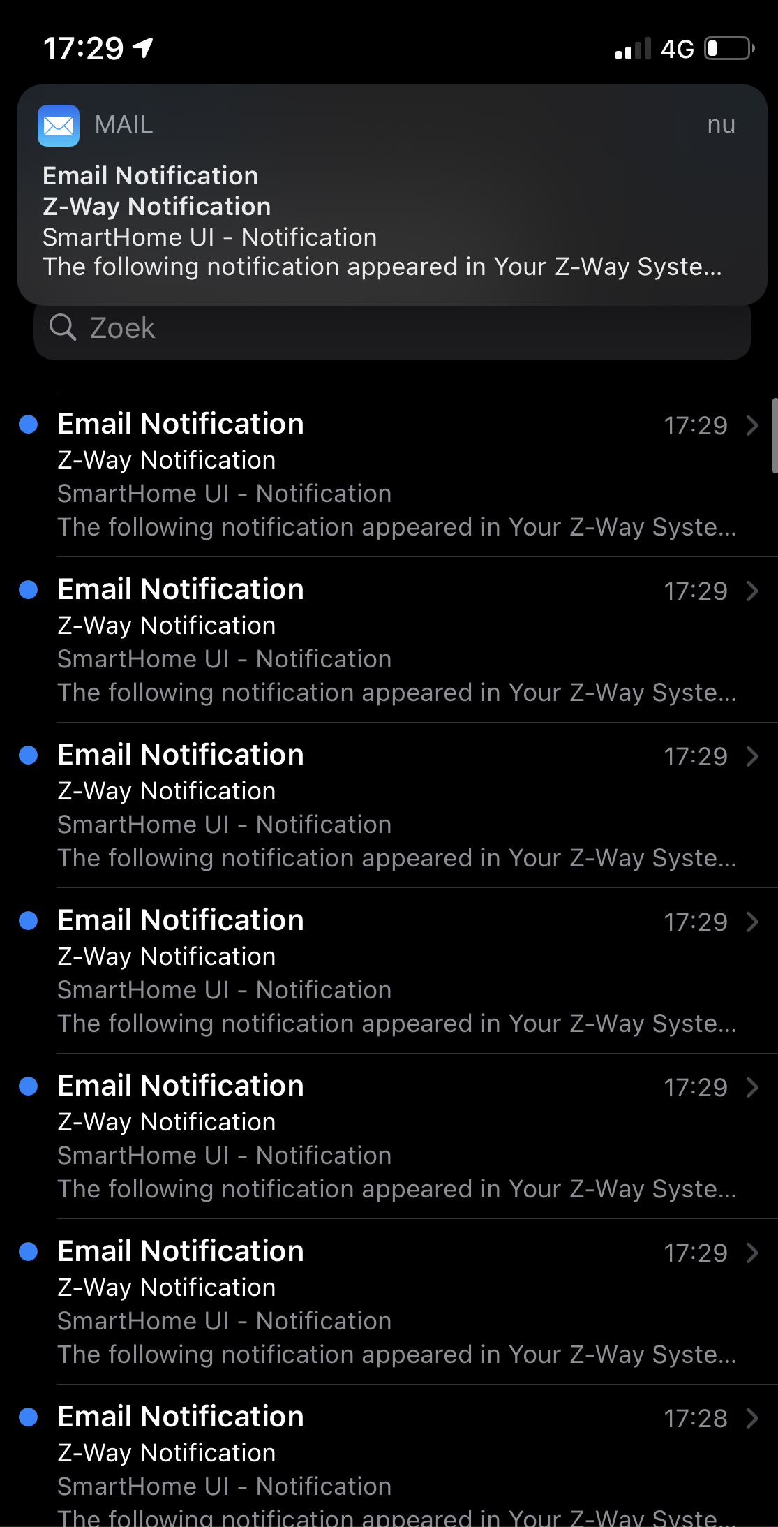

Spammed with same notification
Posted: 28 Sep 2020 18:33
by vinisz
I get spammed (over 218 mails already) about the same error. (Cannot create vdev)
Can the notification system not just send one notification instead of so many ?

During my first attempts with this I also say multiple notifications (but not as many as you) - ultimately the problem must be looked for in your rules, which for some reason or the other probably gets triggered repeatedly. You can check the log to verify that the notification app has been triggered multiple times, so you should ask yourself why this happens. In other words: when the rules properly trigger the actual events, there will not be multiple emails.

@vinisz Please send me in PM th exact mail content and remote access credentials (with admin rights and remote support nabled). We will have a look on it. Looks I know the reason.

I don't have any rules or anything configured... nothing..
I just use Z-way amost out of the box and all automation is in node-red.
The source of the problem seems to be an interview error or something but still then it does send out too many messages.

Will do if problem re-appears
