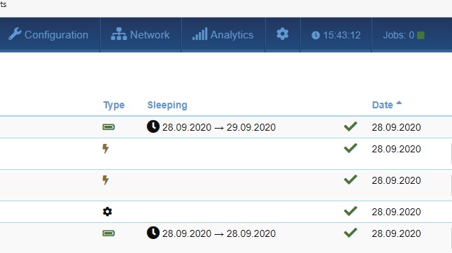

Wondering how to retrieve the "date" field via the ZwaveApi.
I have access to the API, no problem, but can't figure out which field containts the "date" field or what it represents.

I guess you want the field updateTime. It is in Unix-Time format

Thanks,
And which “updatedtime” should I use then, cause I see one for every “setting”
Is the one you’re pointing out here the correct one ?

vinisz wrote: ↑
17 Oct 2020 09:30
Thanks,
Each device have a global attribute updateTime. I think, it is that waht you need. But i'm not sure. If you want to be sure, you could try to figure it out in source code of Z-Way.

Well, for sure it is not that one.
that seems to be the time that device was added or something.
I'm thinking more about the "last received time" now.

I would assume you are searching for lastSend and lastReceived fields and their updateTime propery. Those are used in this part of the UI
