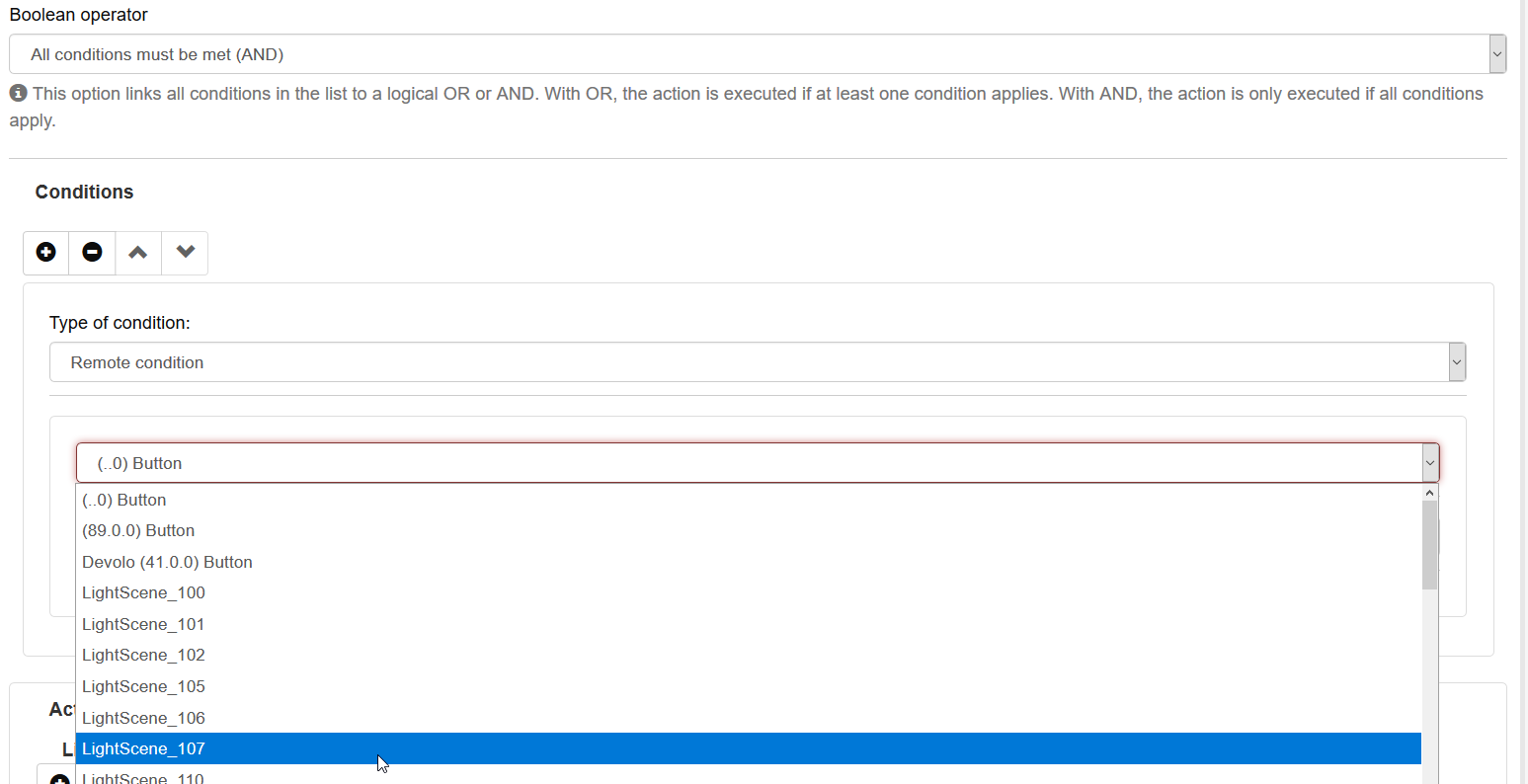

Hello there,
in the logical rule app when you use remote condition the Light_Scene_XYs are being listed but there's no name resolving. Is that intentional?
2020-11-04 17_42_55-Z-Wave Smart Home.png (45.09 KiB) Viewed 13523 times
Best Regards,
rws

Re: Logical Rule Remote Condition Name Resolving
https://github.com/Z-Wave-Me/home-autom ... b393f6edca
That was the change. Please check it

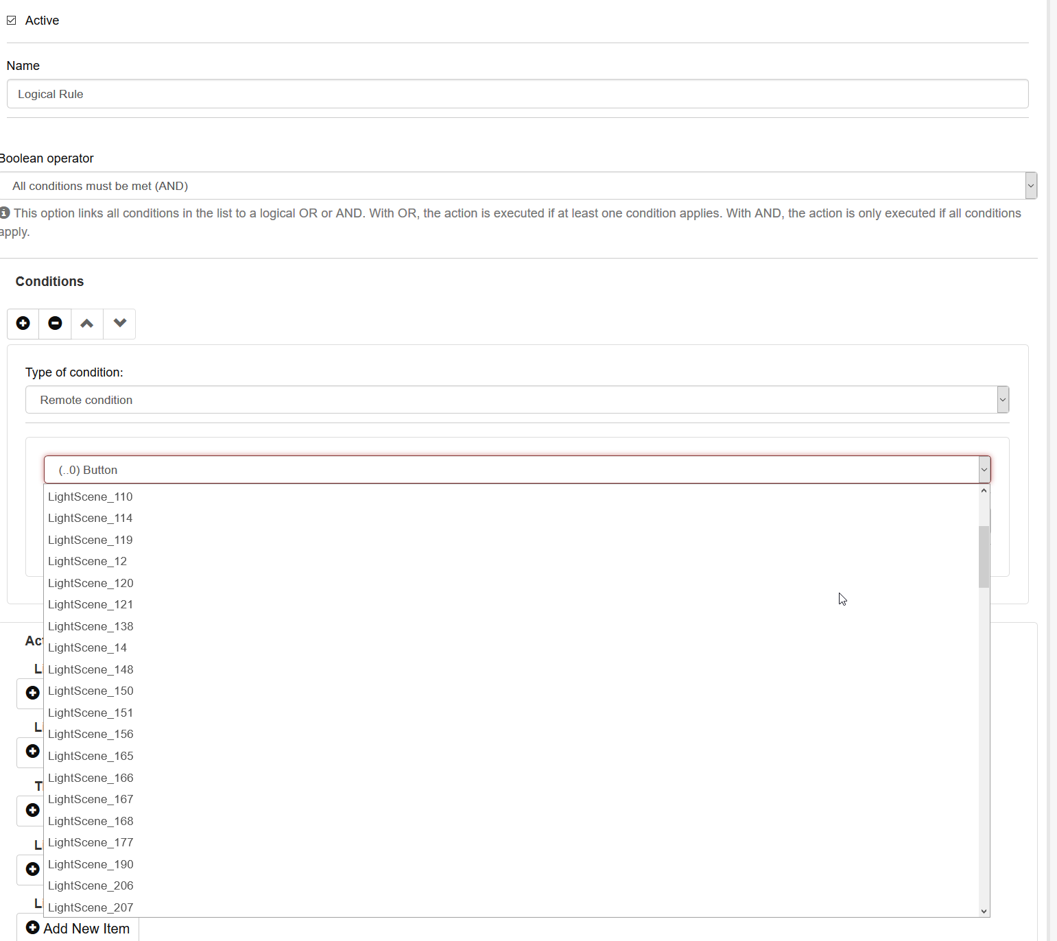

ridewithstyle
Posts: 155
Joined: 02 Jan 2016 01:20
Post by ridewithstyle »
yes, that's what I changed.
here's the grepped file with blank and without blank
2021-01-12 10_36_21-namespaces.png (39.23 KiB) Viewed 13253 times
missing name resolving behaviour is still there
2021-01-12 10_38_31-remote_condition_name_resolution.png (67.6 KiB) Viewed 13253 times
