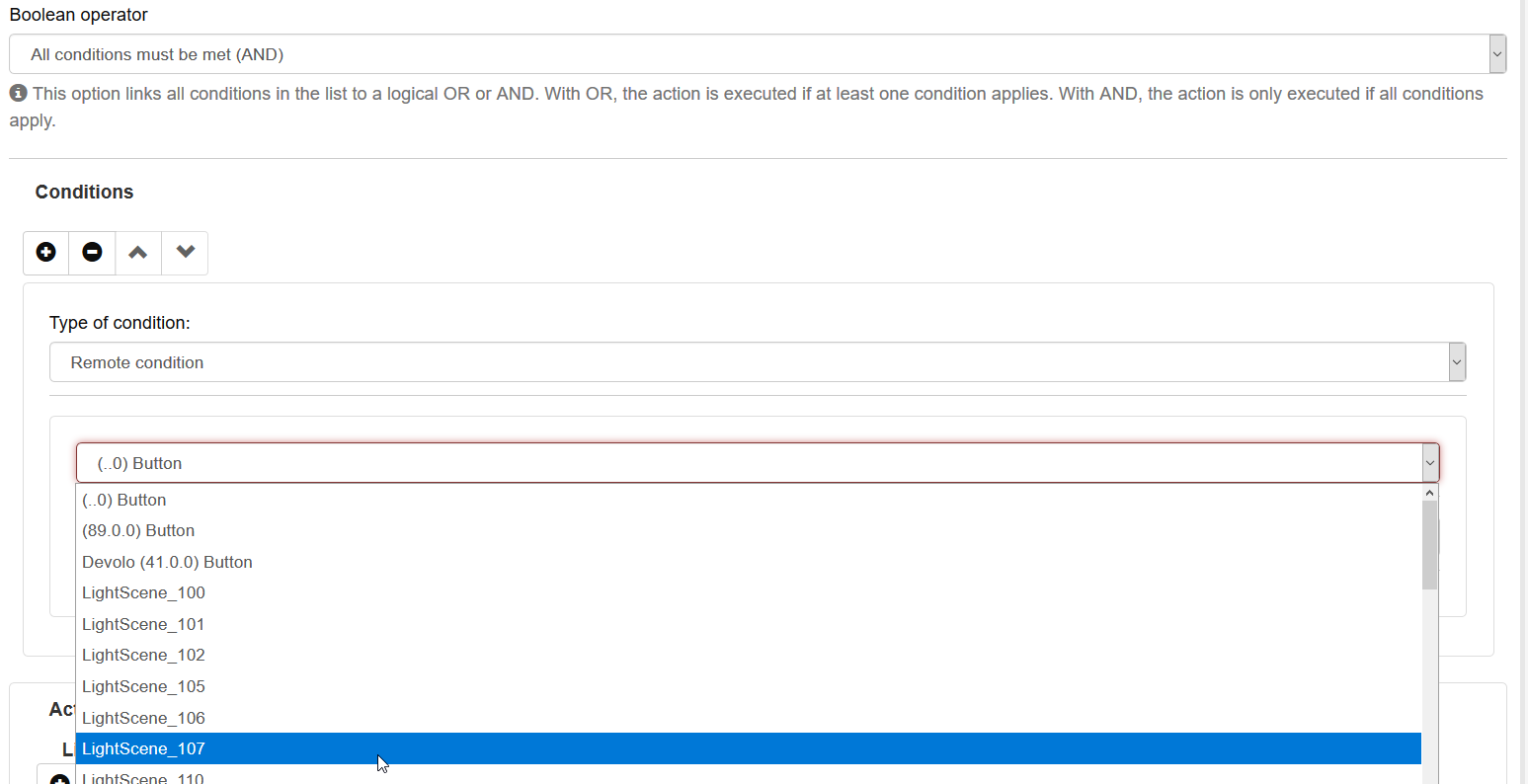

Hello there,
in the logical rule app when you use remote condition the Light_Scene_XYs are being listed but there's no name resolving. Is that intentional?
2020-11-04 17_42_55-Z-Wave Smart Home.png (45.09 KiB) Viewed 13163 times
Best Regards,
rws

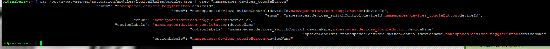

Posted: 11 Jan 2021 18:19
by aivs
Hi!
This will be fixed in the next release.
Now you can fix it manually:
1) Open /opt/z-way-server/automation/modules/LogicalRules/module.json
2) Find all the places with " ,namespaces:devices_toggleButton"
3) Remove the space before the comma
4) restart z-way

Re: Logical Rule Remote Condition Name Resolving
Posted: 12 Jan 2021 04:44
https://github.com/Z-Wave-Me/home-autom ... b393f6edca
That was the change. Please check it
Posted: 12 Jan 2021 12:39
by ridewithstyle
yes, that's what I changed.
here's the grepped file with blank and without blank
2021-01-12 10_36_21-namespaces.png (39.23 KiB) Viewed 12893 times
missing name resolving behaviour is still there
