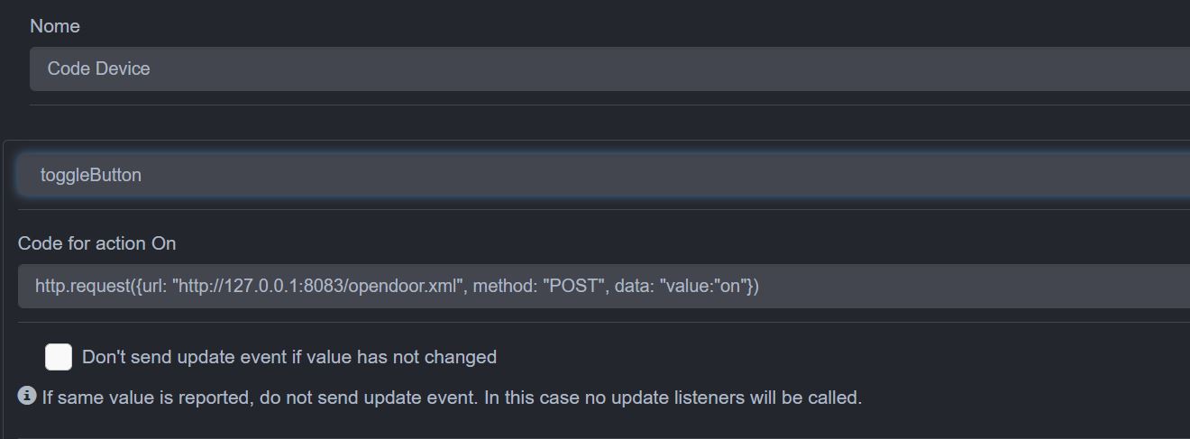

I need a toggle button which when clicked, it change values from off to on into .xml file
So the code I put into web settings page of code device module is:
http.request({url: "http://127.0.0.1:8083/opendoor.xml",method: "POST", data: "value:"on"})
but I get
Error during perform command execution: SyntaxError: Unexpected identifier

1. There is a syntax error:
data: "value:"on"
2. You can not write a file like that with Z-Way web server
3. why not to use code device with system("echo '<?xml version=\"1.0\" encoding=\"utf-8\" ?><value>off</value>' > /some/folder/opendoor.xml") ?
Don't forget to add the command to .syscommands (without escape \)
