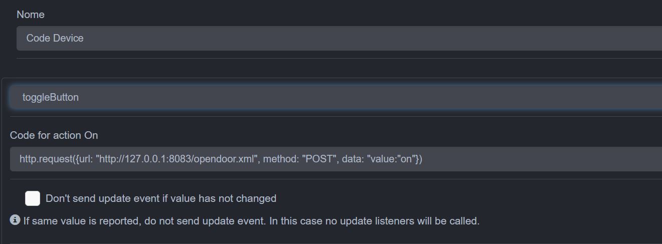

I've just installed a code device app into my zwave.me installation.
I need a toggle button which when clicked, it change values from off to on into .xml file
So the code I put into web settings page of code device module is:
http.request({url: "http://127.0.0.1:8083/opendoor.xml",method: "POST", data: "value:"on"})
but I get
Error during perform command execution: SyntaxError: Unexpected identifier
then my opendoor.xml file content here:
<?xml version="1.0" encoding="utf-8" ?>
<value>off</value>

1. There is a syntax error:
data: "value:"on"
2. You can not write a file like that with Z-Way web server
3. why not to use code device with system("echo '<?xml version=\"1.0\" encoding=\"utf-8\" ?><value>off</value>' > /some/folder/opendoor.xml") ?
Don't forget to add the command to .syscommands (without escape \)

Thank you so much PoltoS, it works! Great!Now the system is much more powerful because I can talk to external python scripts :D :D
