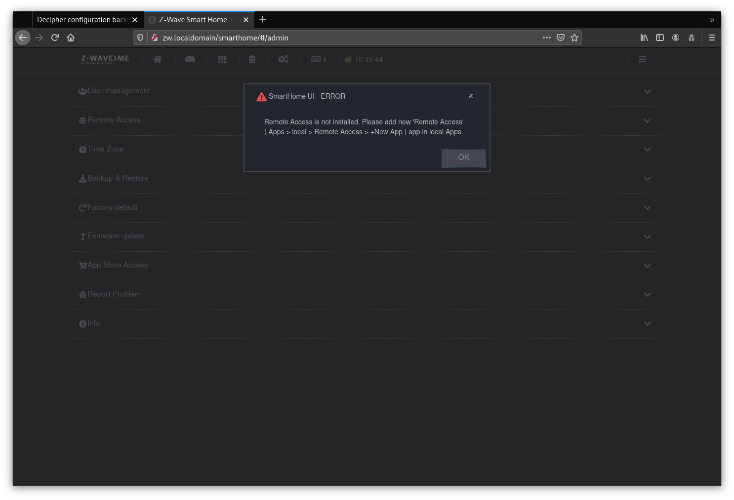

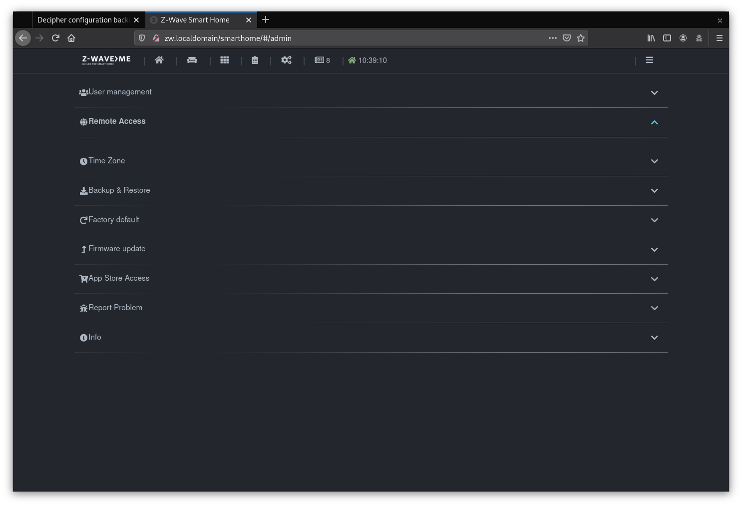

no possibility to change configuration - empty
Skärmbild från 2021-01-31 10-39-12.png (63.67 KiB) Viewed 7856 times
error message
error message
Skärmbild från 2021-01-31 10-38-45.png (72.14 KiB) Viewed 7856 times

Using linux, and would like to get rid of the error message and remove the remote exploit before starting the service.
