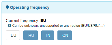

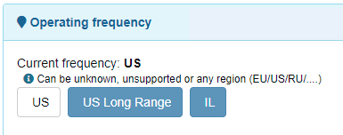

THANK YOU!!!! I wish the instructions were more accessible.
I was able to change my UZB to US region frequency with http://localhost:8083/JS/Run/zway.ZMEFreqChange(3)
- for anyone else read this, it seems as if the command was successful, return is simply "null".
Oddly enough Z-Way's display changed once I updated the dongle. How helpful.
Screenshot 2023-11-20 at 2.05.54 AM.png (12.99 KiB) Viewed 26859 times
to
Screenshot 2023-11-20 at 2.12.06 AM.png (13.81 KiB) Viewed 26859 times
