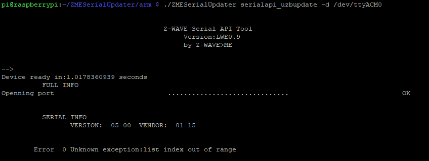

can it be zway doesn't like the old-school UZB with FW 5.00? At least that's apparently the one I have, you guys probably can confirm from the screenshot attached?
UZB Version 05 00 VENDOR 01 15
Oldschool UZB FW 5.00.png (16.13 KiB) Viewed 3931 times

Tried upgrading FW and/or bootloader, no luck. It´s doing something but won´t go through in the end. I can "readnvm" but not much else. The -c argument from the "manual" seems to be invalid, so can´t reset the UZB either.

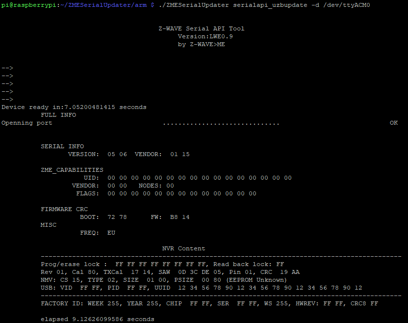

With the proper commands, I was able to flash the 5.02 firmware manually. The published manual on the website is complete crap. After the update of the FW to 5.02 (successful, see comand below), the UZB shows up in Zway expert mode with all it´s details. From there I updated further to 5.06 which seems to be the maximum for this HW revision. Changed frequency to EU also via "expert mode". Attached now my status for the UZB.
./ZMESerialUpdater serialapi_firmware -d /dev/ttyACM0 firmware_UZB_from_05_00_to_05_02.bin
Note to the team: Update your f****** manuals!
Success!
Success!
UZB updated.png (34.28 KiB) Viewed 3927 times
