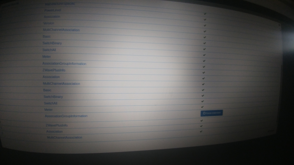

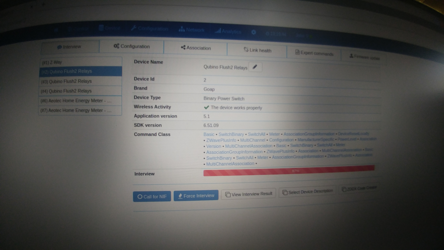

I am having trouble including Qubino flush 2 relays to my Razberry 2 Z wave controller. The interview process will stop at 97% on the assosiationGroupinformation stage. Any advice on what I might be doing wrong would be hugely appreciated.
I have attached a couple of photos.
Thanks in advance.

I'm also stuck at 97%, but it doesn't seem to matter, the relay still works as expected.
In versions prior to 3.x the interview completed successfully.
There are a number of different interview problems since v3.x, which I didn't experience in previous versions.

Had the same problem, and it's a known issue
Z-Way Version 3.0 - Interview buggy
