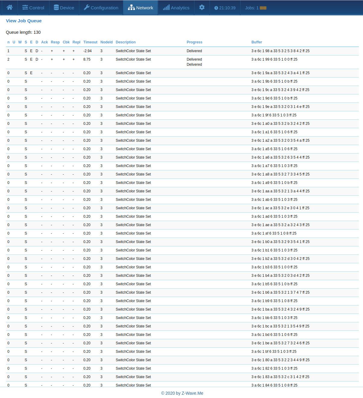

I have couple of Razberrys, firmware 5.39EU, Z-Way 3.2.0 (3.1.4 also tested), so I tested with stock Z-Way install, only FIBARO module included to the controller. I've made simple user module to switch RGB and W to random value every 10 seconds.
Attached is log and screen of filling queue. Can some shed some light on it? I'd really like to use this FIBARO module.
I can not see anything wrong within the log besides "Job is already marked as waiting for reply, Supervision overrides it - check encapsulated packet not to be a Get".

As I am having problems with this FIBARO module, I've found this thread in official FIBARO forum https://forum.fibaro.com/topic/49893-co ... activated/
So the module fades between RGBW colors on color change for configured amount of time, as any RGBW module would do. Let's say you have red and you want to change to green - there will be (by default) 3 seconds fade between those colors. It is nice effect.
But... for those 3 seconds, THE DEVICE WILL NOT RESPOND TO ANY PACKET ON RADIO!
This is unbelievable... It seems that internal firmware does this fade single threaded. Again, this is unbelievable in 2021. On high level, the device works, so you can not complain. Firmware update (if it will be ever released) is no go, as FIBARO *requires* you to own their controller to do firmware updates.
For anybody reading this: just don't buy this crap. If you did, change parameter 152 (2 bytes) to 0. The color change will be instant (and ugly) but the device will be responsive.
