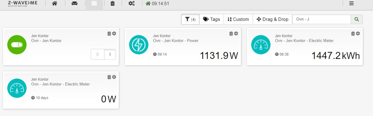

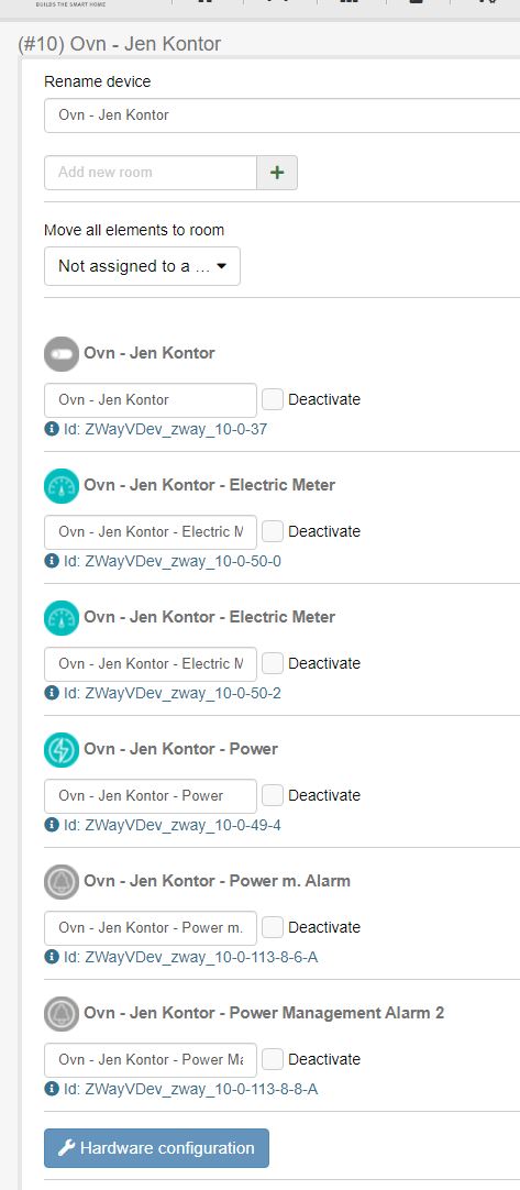

This is the Device definition:
This is how it appears. The kWh is updated correctly though..
Re: Fibaro Dimmer 2/Wall Plug Command classes
Ah, got you. In Z-Wave there are historically two ways to report W - in Meter (which is not really good as meter is a cumulative value) and via Sensor Multilevel (which is better). New devices uses the latter one, but still have the former for legacy purposes. Not sure why Fibaro is not reporting for one of them, but just disable it and don't forget about it - you have the other one
