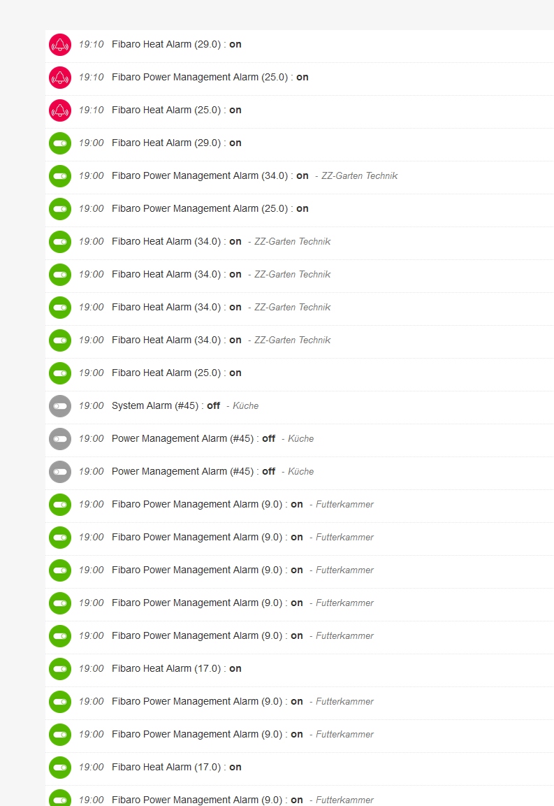

Hel
Many (All) of my Fibaro Devices sent all 10 minutes an
- Heat alarm
- Powermanagement Alarm
What can I do ?
Firbaro Heat Alarm.png (85.44 KiB) Viewed 9075 times
Thanks

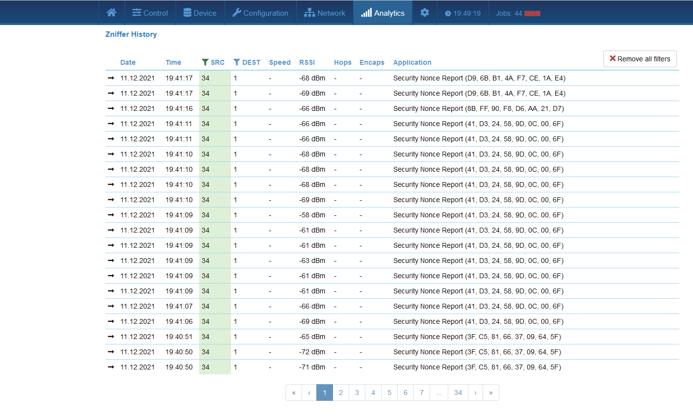

A couple of suggestions...
1. To understand what's being sent by your Fibaro device, point your browser to: http://[IP Address of Z-Way controller]:8083/expert/#/installer/history
2. Look at the Z-Way controller log file (nominally /var/log/z-way-server.log) to see how Z-Way is processing the Fibaro messages
3. Power-cycle the Fibaro device by removing and re-installing the battery - that should update its routing table
A likely explanation is that the Z-Way controller is sending an ACK message back to the Fibaro device, but the Fibaro device is not receiving the ACK message so it's re-transmitting the alarm messages. Issues related to weak RF signals can be difficult to troubleshoot because the conditions are frequently intermittent. The RSSI data in the Zniffer history can be useful.

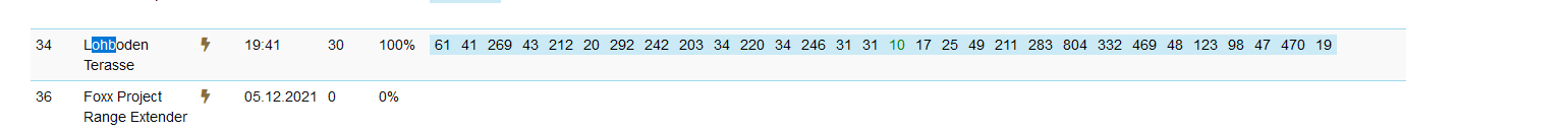

thanks for your Reply.
DEV34-Timing Info.png (7.97 KiB) Viewed 8994 times
Do you need further more Infos ?
Greetings from germany
Jörg
Re: Fibaro Heat alaram
There is a clear routing issue here:
- up to 2 and even 8 seconds to reach the device! (804 * 10ms) in timing info
- a lot of duplicates with Nonce Reports with same values
- big duplicates level
check route map (switch to ingress packets by pressing "I") and see real routes. If they are crazy, assign manual routes and add repeaters

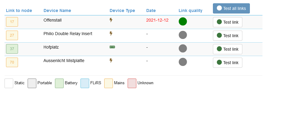

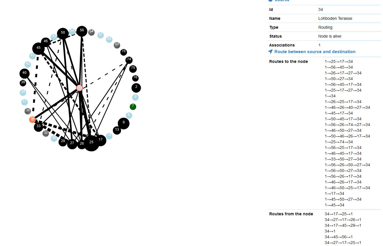

DEvice34 Routemap.png (85.08 KiB) Viewed 8951 times
This is Route map for Device 34 .
There was an Bold Line Direktly to the Controler. But in there was no Link to Controler...
Can you explain it ?
DEvice34 Links.png (17.63 KiB) Viewed 8951 times
Jörg
wow! what a mess. So many routes are a sign of very bate routing and reception.
I would suggest uploading a floor map, placing devices on it, and then seeing where is the weak point. All the dashed lines are links with losses.
Neighbours map shows a known routing table based on the last node neighbours update. But devices still tries to use the direct route - it is allowed. As a result, you can see them in the Route Map. Route Map shows REAL routes used in the last few hours, while Routing Table shows the state from the last neighbour update.
