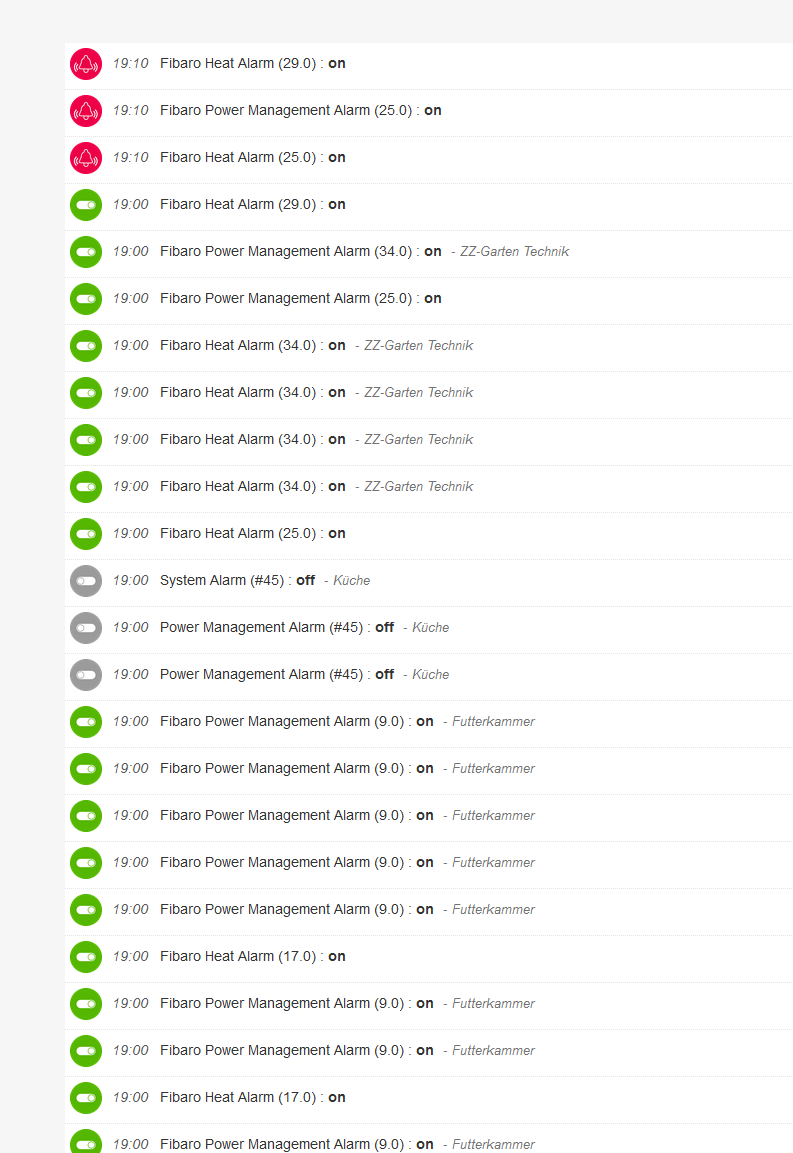

Many (All) of my Fibaro Devices sent all 10 minutes an
- Heat alarm
- Powermanagement Alarm
What can I do ?
Firbaro Heat Alarm.png (85.44 KiB) Viewed 9081 times
Thanks

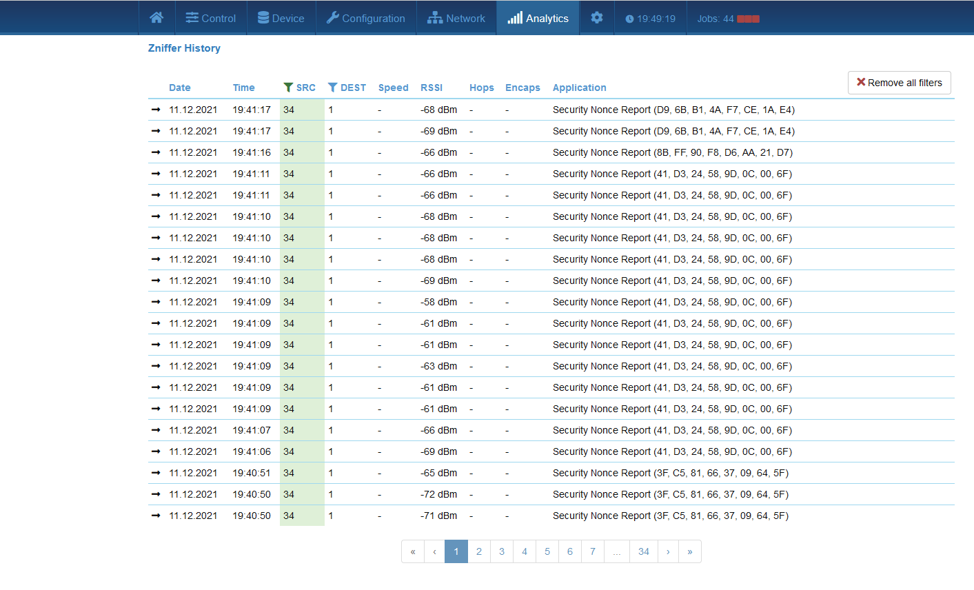

thanks for your Reply.
DEV34-Timing Info.png (7.97 KiB) Viewed 9000 times
Do you need further more Infos ?
Re: Fibaro Heat alaram
Posted: 12 Dec 2021 02:07
There is a clear routing issue here:
- up to 2 and even 8 seconds to reach the device! (804 * 10ms) in timing info
- a lot of duplicates with Nonce Reports with same values
- big duplicates level
check route map (switch to ingress packets by pressing "I") and see real routes. If they are crazy, assign manual routes and add repeaters

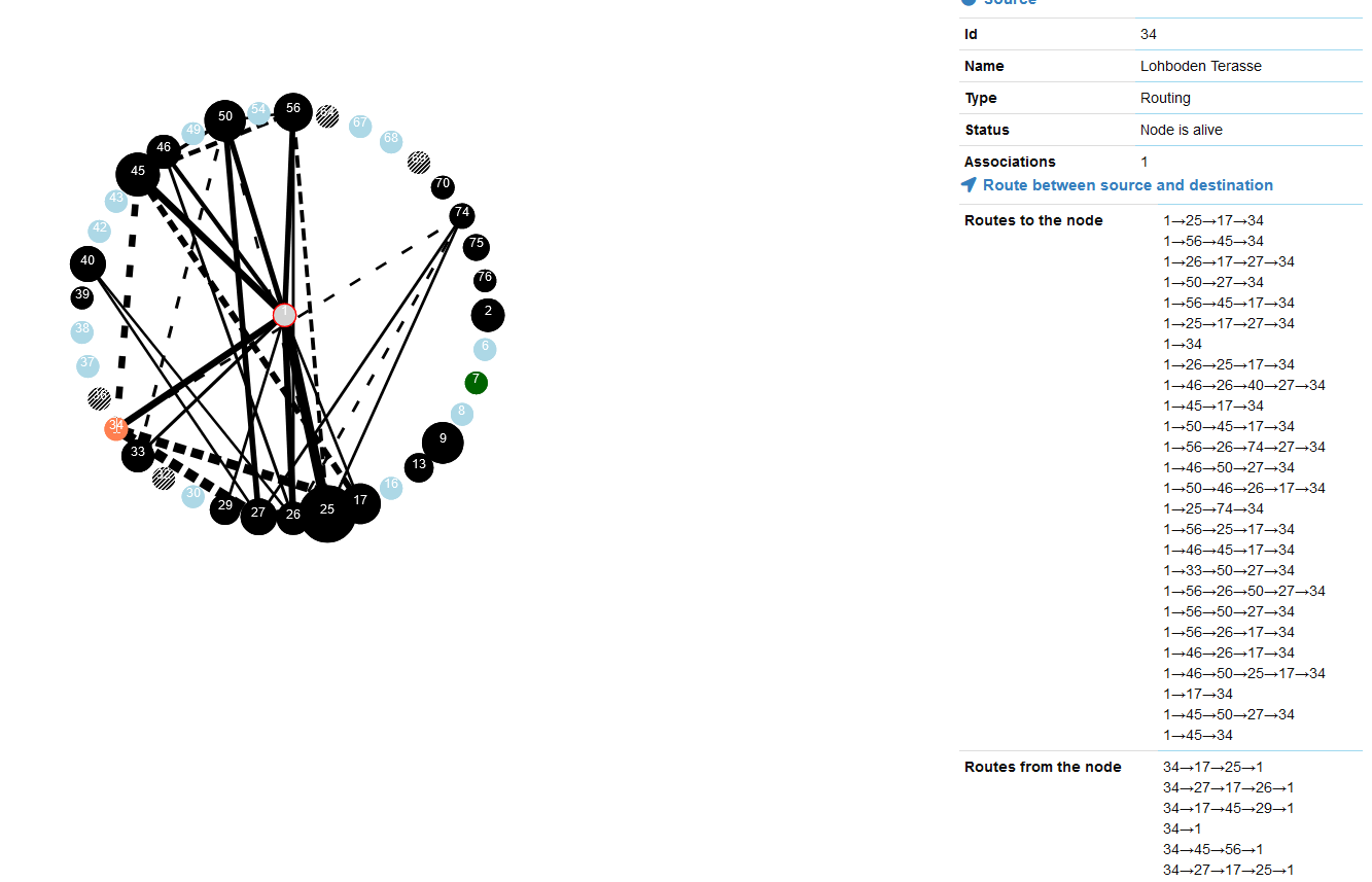

DEvice34 Routemap.png (85.08 KiB) Viewed 8957 times
This is Route map for Device 34 .
There was an Bold Line Direktly to the Controler. But in there was no Link to Controler...
Can you explain it ?

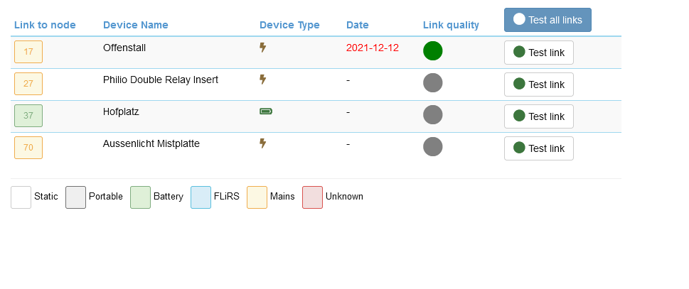

DEvice34 Links.png (17.63 KiB) Viewed 8957 times
Posted: 14 Dec 2021 00:31
wow! what a mess. So many routes are a sign of very bate routing and reception.
I would suggest uploading a floor map, placing devices on it, and then seeing where is the weak point. All the dashed lines are links with losses.
Posted: 16 Dec 2021 01:34
Neighbours map shows a known routing table based on the last node neighbours update. But devices still tries to use the direct route - it is allowed. As a result, you can see them in the Route Map. Route Map shows REAL routes used in the last few hours, while Routing Table shows the state from the last neighbour update.
Posted: 16 Dec 2021 16:57
by J.nissen
Hello PoltoS,
Thank you for your explanation
If an Manuel Route is defined - ist that than the Only Used Route ?
