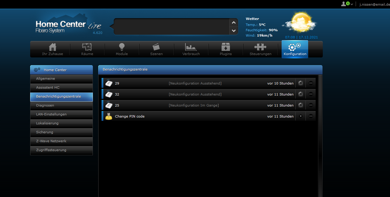

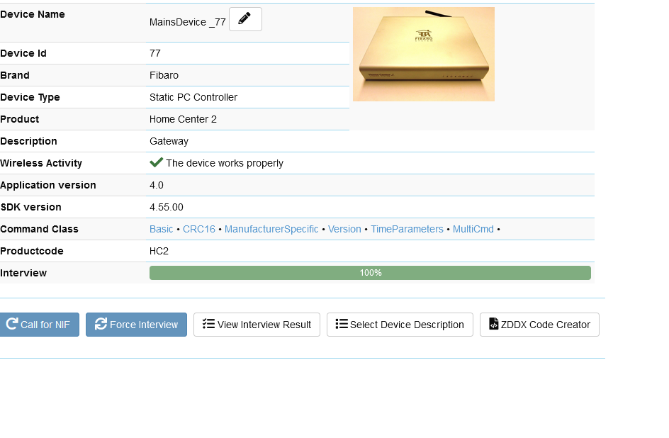

I have added an HCL 2 Lite as secondary Controler.
Then I started Soft Configuration...
But the Soft Configuration doesn´t work.
It find no End ...
2021-12-17 07_08_41-Home Center Lite.png (145.37 KiB) Viewed 9922 times
2021-12-17 07_13_58-Z-Wave Expert UI.png (85.47 KiB) Viewed 9922 times
Has you any Idea ?
